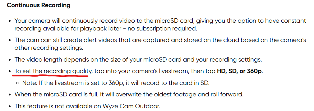

There is a mistake on that website about changing recording quality:
and we will correct it as soon as possible. Thanks again for your help and info!
To me this sounds like an oxymoron. You are saying that no matter what we select the recorded video on SD card will be HD. But then you are saying that if we change the stream to SD it will record to SD???!!!
Can you please be more specific!
