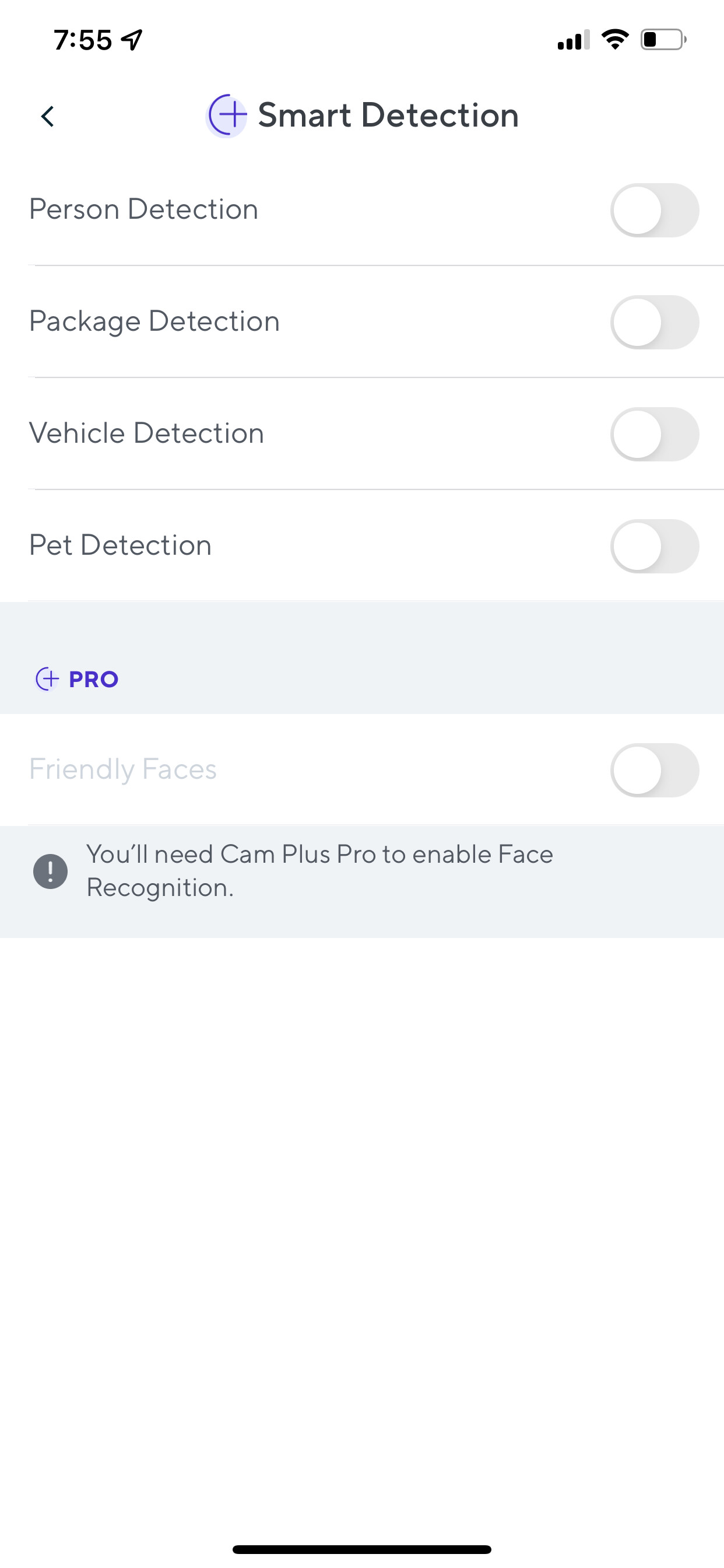

Yep. I foolishly made a ticket and sent my logs and never heard from them after that. I only get Person, Sound and Pet notifications. But there’s this:
And then I get this when I try to toggle anything (I’m already a Cam Plus subscriber):
I’m basically clueless.
Just click on the top right x, and you should be able to see your subs.
Exactly. I’m already subscribed. The app says otherwise. Wyze won’t get back with me so I’ve given up.
