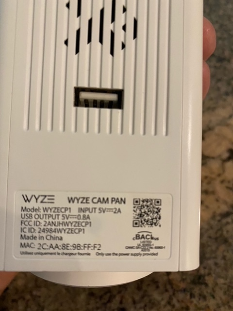

I’m having the same issue with the pan. Tried multiple ways to update including via flash drive with no success. Any assistance appreciated.
Hi. Sorry for the inconvenience. May I ask what is your App version? If your App version is up-to-date, what is the error code and LED status when your pan can’t connect? Thanks.

Here’s the pic of the back of the cam
