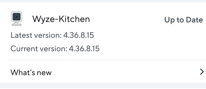

I just purchased a couple of the Wyze Cam 3’s from Home Depot.
I’ve noticed the firmware is at 4.36.8.15.
Iam a beta tester for firmware yet the app as well as device info tell me the camera is up to date.
Rebooted, unplugged and plugged back in and have removed and re-added… No change in regards to firmware upgrade.
How do I get this to update.
Remove beta testing for V3s and your cam will update to 4.36.9.139 right after. You will have to wait for the next update to be fixed(4.36.10.3406). I bought 2 v3s last week and that’s what I did.

Thank you, this worked for me. I also got the Home Depot 2-Pack and strangely, 1 cam updated to 4.36.10.3406, but the other one was stuck on 4.36.8.15. I followed your suggestion to remove it from Beta and then it at least allowed me to update to 4.36.9.139. I tried to then switch back to being enrolled in Beta, but to no avail. Still stuck at x.9.139. Ah well, better than being stuck at x.8.15, so I appreciate the suggestion.
I should’ve just flashed the firmware to 4.36.10.3406 while I had the cam near me at my desk, but now it’s in an inconvenient location and I don’t want to bother with it, so this was very appreciated for the time being. Wish I could just confirm that I know there are risks and want to push the x.10.3406 firmware to my cam anyway. They should at least allow it for people enrolled in Beta. :slight_smile:
Thanks! Removing the Cam3 Beta did allow it to upgrade to .9.139.
Set back the Cam 3 beta and we’ll see if it will at some point pick up the .10. release.

About a week ago I received three V3 black cameras direct from Wyze. They all had 4.36.8.15 and would not update beyond that. Reading this thread, I removed the V3 from the Beta program, and sure enough I was immediately able to update all three to 4.36.9.139. Turned the V3 back on for Beta and we’ll see what happens. Sounds like they will be there for a while. All the rest of my V3 cameras (except two that have RTSP firmware) are 4.36.10.3406.
Thanks! Got stuck setting up another v3 Black today. Removing v3 from beta worked to get from 4.36.8.15 to 4.36.9.139. Then flashed 4.36.10.3406 via SD and all is well. :+1:
