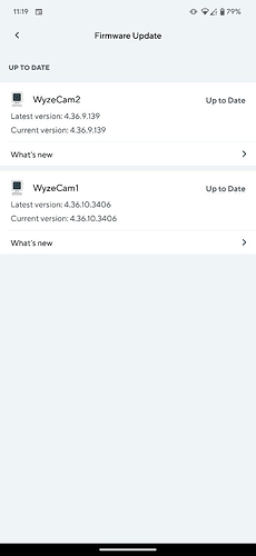

Thank you SO very much @SlabSlayer for your wonderfully detailed and super informative message(s). I’d been patiently waiting for further updates after quickly adding a second camera before the holidays, but it seems i need to either manually flash the newest v3 Cam, or continue waiting patiently.
For a bit of additional context, we’ve had the WyzeCam1 v3 for quite some time, which is how i must have stumbled my way into that beta? version (4.36.10.3406) of the firmware

Version 4.36.10.2700 and .2864 we’re both public release updates open to public OTA update for a very brief period of time (before they were quickly halted) when any user with 4.36.9.139 could have updated without being in the Beta. If you happened to select the update during that limited time, you then we’re qualified to get further 4.36.10.xxxx updates. Once the .10 version(s) was identified as significantly problematic for a large number of folks, Wyze slowed their roll and are now only updating previous .10 versions until they can verify its stability.

Because 4.36.9.139 is the last version of public release firmware available for all V3 cams to update.
That is correct. There were two versions of 4.36.10.xxxx that were offered very briefly for OTA update after 4.36.9.139, however both were very quickly halted due to event recording issues. Anyone who didn’t update was cut off from moving to 4.36.10.xxxx. Anyone who did update was then offered a fix to those two versions in 4.36.10.3406 which is only available OTA to cams already on a 4.36.10.xxxx version. It is, however, publicly available for manual download and flash update.
Hopefully this newest version, or the next beta, will prove stable enough to be released OTA to all V3 cams.
