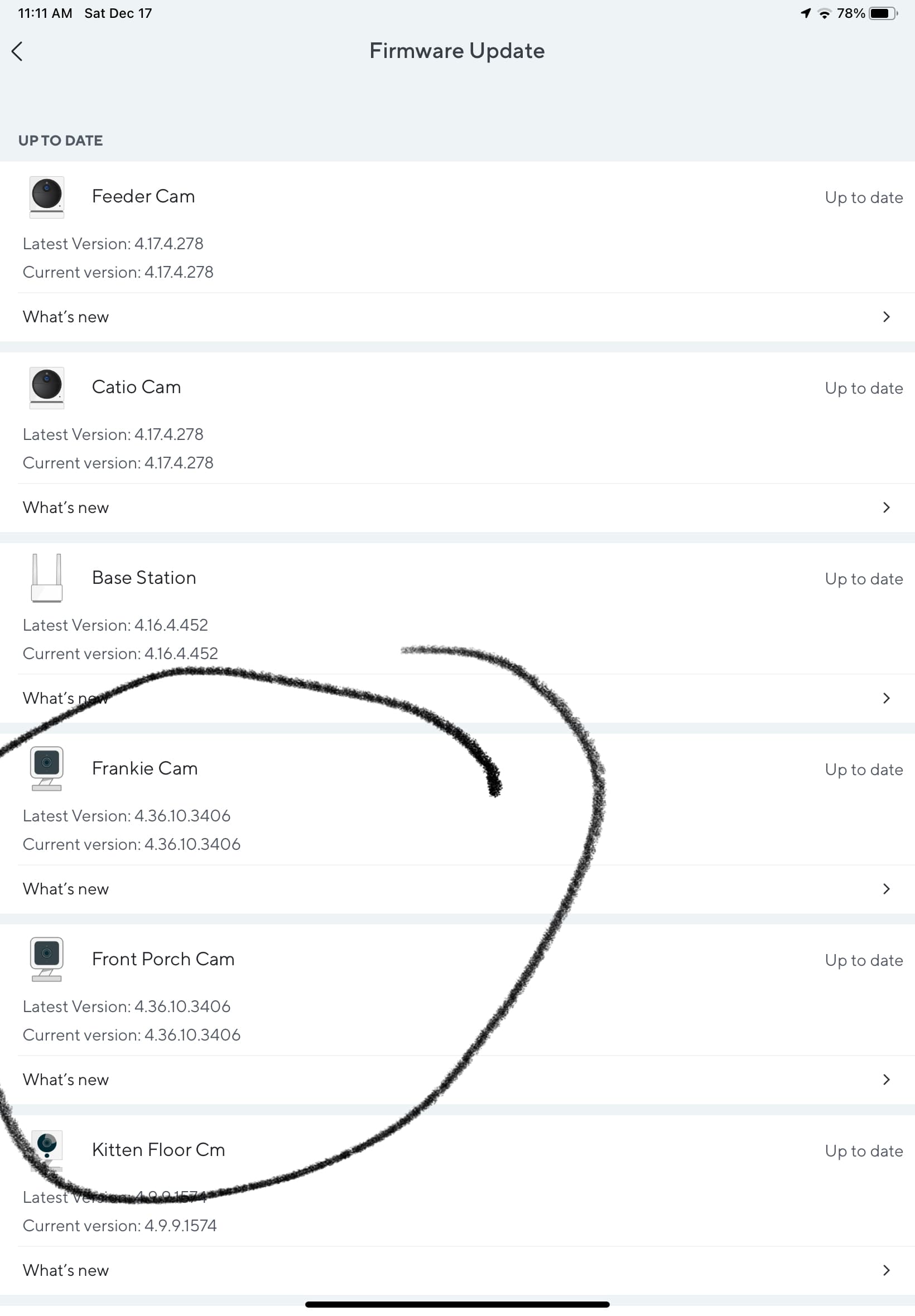

Is this firmware update supposed to take over 30 minutes to install through the app?
No definitely not
Oddly
All of the sudden the firmware updates are now working
Nothing changed on my side, and the wireless network is working fine.
Techno anomaly

The issue I had with updating the Cam V3’s
Seem to be 2 issues
I had to remove the power plug ( count to 10 sec rule, and plug back in)
(10 sec rule allows energy to disperse from the circuitry - and then plug back in - just rebooting did not work)
Then tried the update, it worked.

You could grab the 3406 firmware on this link and try the SD card update. https://support.wyze.com/hc/en-us/articles/360024852172
Here is how to do a manual flash. https://support.wyze.com/hc/en-us/articles/360031490871-How-to-flash-your-Wyze-Cam-firmware-manually
Just tried the manual flash method on a V3 that was "stuck"at 4.36.9.139 to 4.36.10.3406.
So far so good.
