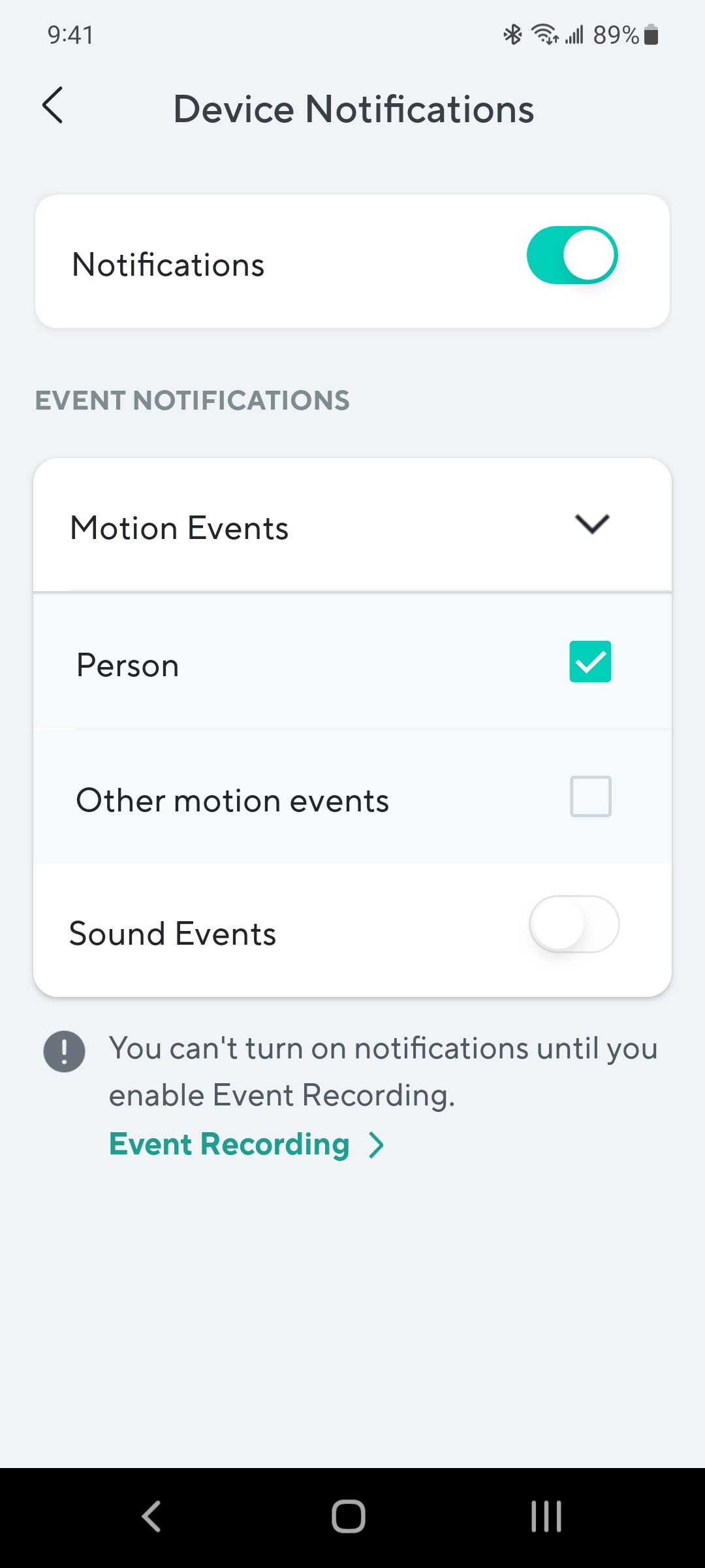

Just to follow up. I did some checking in the Wyze app.
The Notification settings are inconsistent.
I am attaching screenshots of the Notification settings on the same camera 4 minutes apart. Notice the difference in Motion Event options.
Opening Notification settings also takes 20-30 seconds.

I am curious, the cameras you showed the ‘Device Notification’ images for, what firmware is each one of those on?
Hey Jason :wave:
The middle and right-hand images are after updating to 4.9.9.1851.
The middle had been updated from 4.9.8.501.
The right-hand had been updated from 4.9.8.1002.
Both images are from the same camera, 4 minutes apart.
V2 cam, Firmware version: 4.9.9.1851
