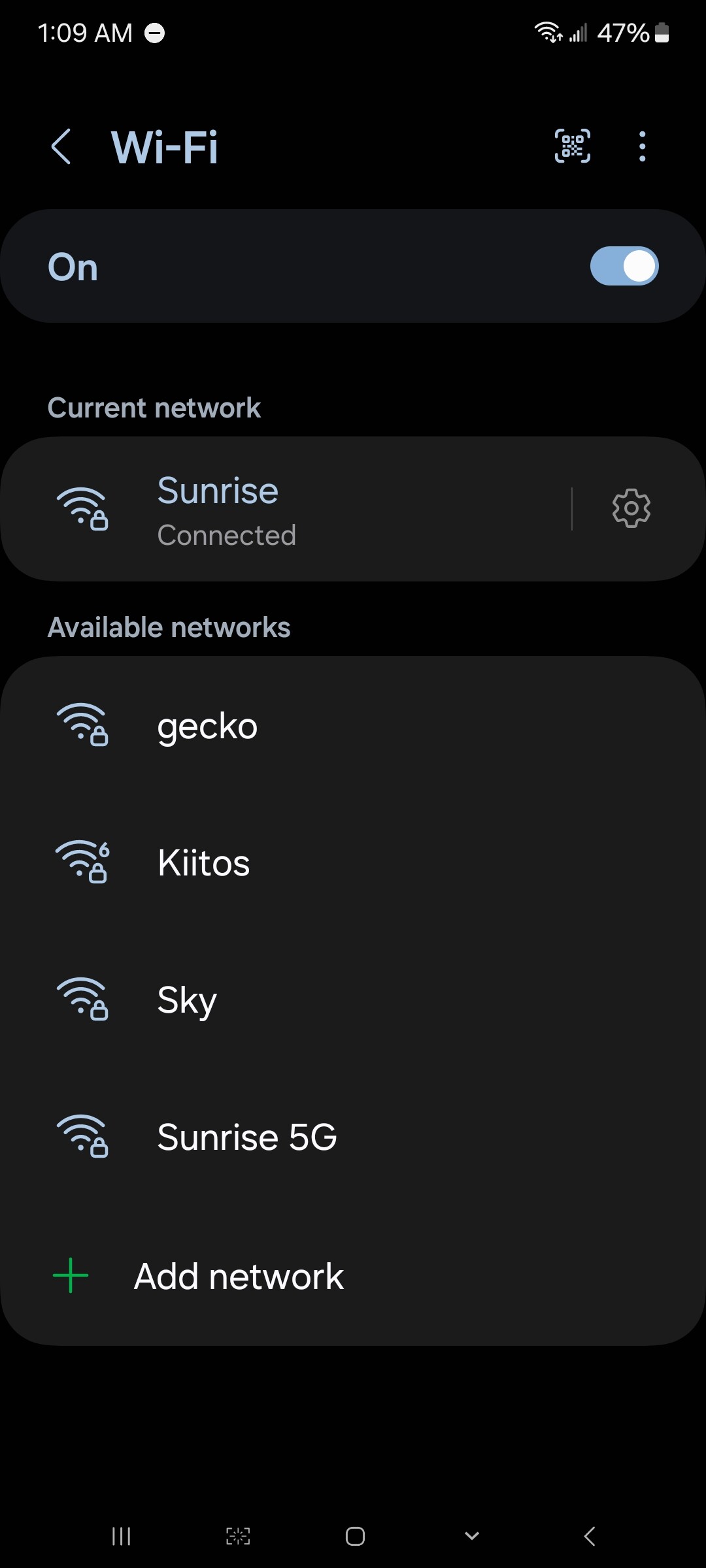

Apparently, I have the same issue with my Wyze 2019 bulbs (2). I haven’t used them in a year or so. I saw this thread and decided to try getting my bulbs back online. I have a new Samsung S24 with Android 14 and One UI 6.1. (I also tried my backup S21 with same software.) The Wyze app version is v2.50.6 (469).
Everything proceeded as normal up to connecting to the bulb’s network. Then the bulb network did not appear.
As I started, I turned the light on and off 3 times and the bulb flashed. I clicked next.
I selected my network and clicked next.
I received a prompt that says to connect to “Wyze_smartbulb_apxxx”. I click choose wifi.
Bulb network does not appear.
On this try, I am connected to a network that only supports 2.4 GHz. I wanted to rule out any conflicts with having 5 GHz in the mix.
I tried two bulbs and each time I do not see the bulb network.
I tried another network with another bulb and I have the same issue.
