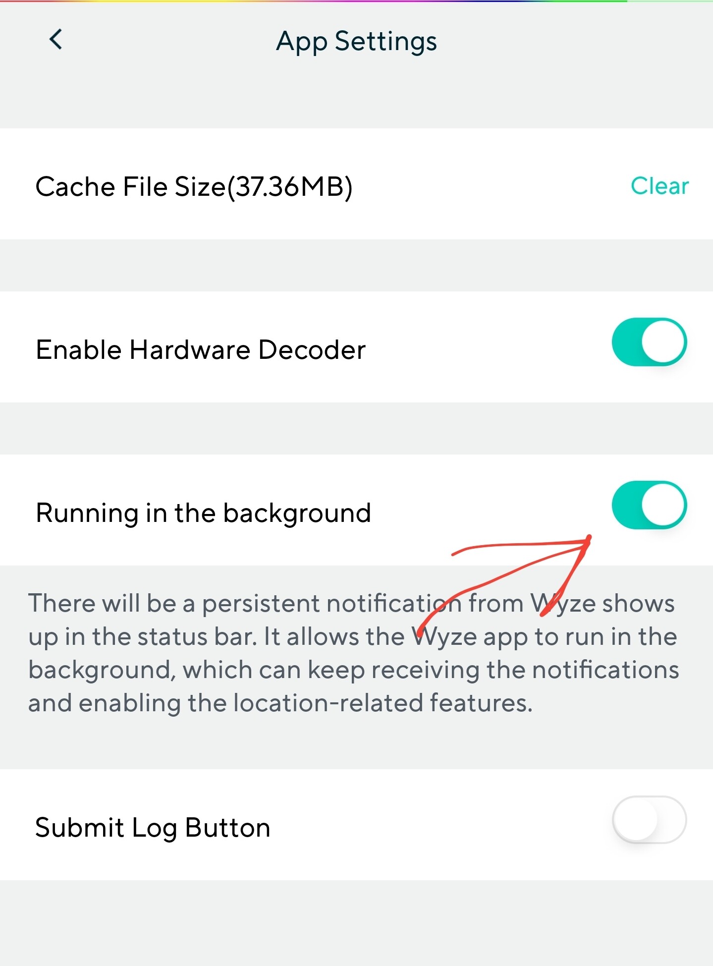

No - So here is what happens:
- I start the Wyze app and it gets notifications without issue. Run in background is set as I also use the watch.
- I shut down the app and let the background notification run. I get no notifications at all, not to my watch - which I expected. However, Alexa will announce and my iPhone will notify.
- I have all the usual settings for ensure notificaitons will come through and have not had the issue until the latest App was loaded.
When this first started to happen I did the following to try to resolve it:
- Cleared Cache, force Stopped the app, and then Cleared Cache from Android. Did not fix it.
- I was using Android 12, I reset the phone and went back to Android 11. Loaded the app and tested again, did not work.
@carverofchoice is also experiencing this issue. You only get the notifications when the app is physically open and running.
To get that version to load, I had to remove the existing app and then load the new one from the App store. I did this because it was not showing up as available.
So bottom line is on, Android only, No notifications are being provided unless the app is physically running.
Make Sense?
Here is the image which shows it is running in background…

however, just now, I went into the app settings, to clear the app cache, and noticed The toggle for " leave running in background" was off (it had been on, but it must have been somehow switched off after the last update)
turned it back on, and notifications seem to be working fine again…
