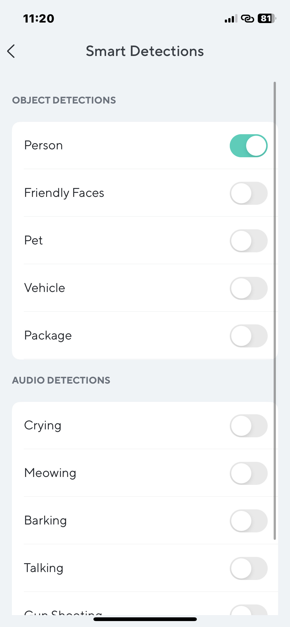

I have “smart detections” with just person selected. It’s working fine on my other wyze cameras that are set up the same way. Unfortunately the doorbell keeps alerting me about cars even though only person is toggled on.

The dumb thing is the menus are different from the wyze camera.
This is the doorbell settings menu (which suck).
This is every other wyze camera menu which have worked really well for me.

@Elysiumsun exactly! I have everything but “vehicle” selected in mine, but alllllll day I get “Vehicle detected…” notifications, even when it’s just a tree waving and my neighbor’s parked car is visible in the driveway. Super annoying. I had to turn on detection area to block the tree/road, but sometimes even the shadows of the trees waving sets off the vehicle notification. On top of that, it’s now blocking out my driveway so I won’t get notified if someone is around our vehicles. It’s either that or no notifications at all…
Same issue here. Only Person is selected for “smart detection” in the event recording settings for my doorbell. Vehicle is turned off. After testing thoroughly, it appears like the “vehicle” option is stuck in the “on” position.

Unfortunately this won’t work. If you look at my previous posts you’ll see my settings show only AI alert I have selected are for person detection.
Also, I only get vehicle alerts because vehicles are driving down the street (where I have blocked the detection zone out) and not from bushes moving. When I go back and look at the alert it’s always a vehicle. It’s not the wind.
There is a major software issue which continues to send vehicle alerts even though the detection zone area is blocked out and the AI for person is the only AI selected.
I have several other cameras all with vehicle detection off. They don’t send alerts to me.
Also as I pointed out in a previous post, the fact that the doorbell has a different AI menu is dumb. I can’t help but think that’s contributing to the issue.
