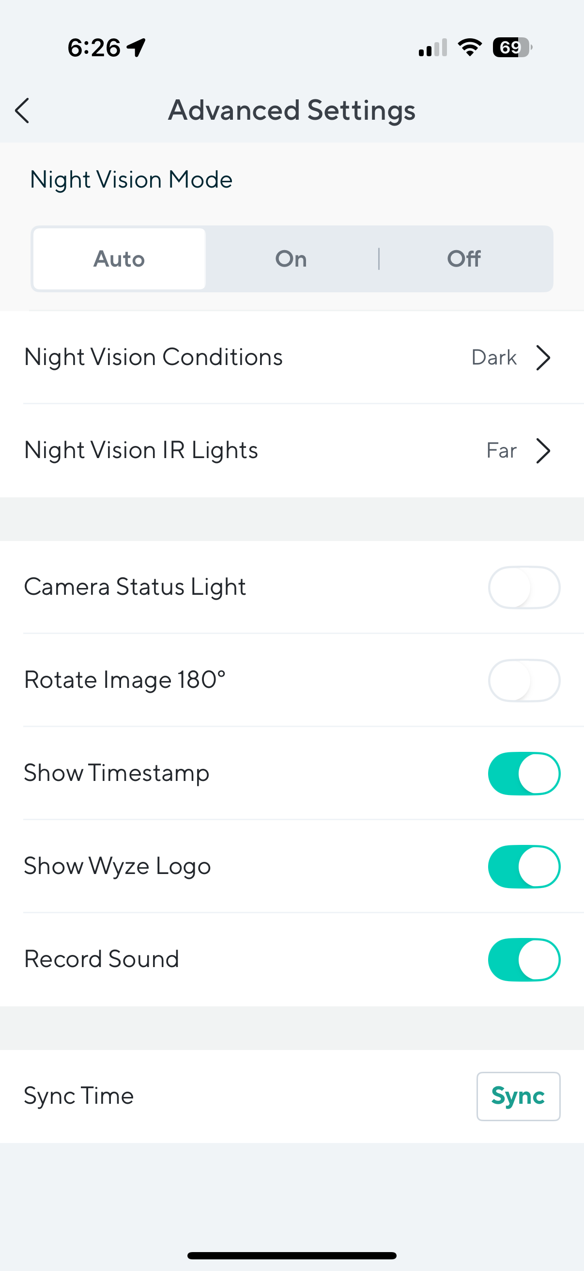

So I had to open up my garage door controller, where you go in to actually cycle the night vision mode to auto on or off just below that bar is night vision conditions, you can click dark or you can click dusk, Try switching those, the dusk is for an environment that has low light whereas dark is for an environment that has extremely low light, Click the opposite of what you have now and let us know the result there. I’m thinking someone might be right but typically if it’s switching to IR and night vision at all the lens for IR is also moving. It feels to me almost like the lens is delaying. I’m yet to see that one but it’s quite curious

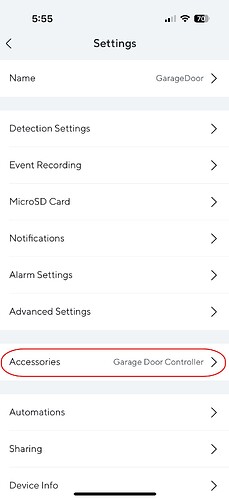

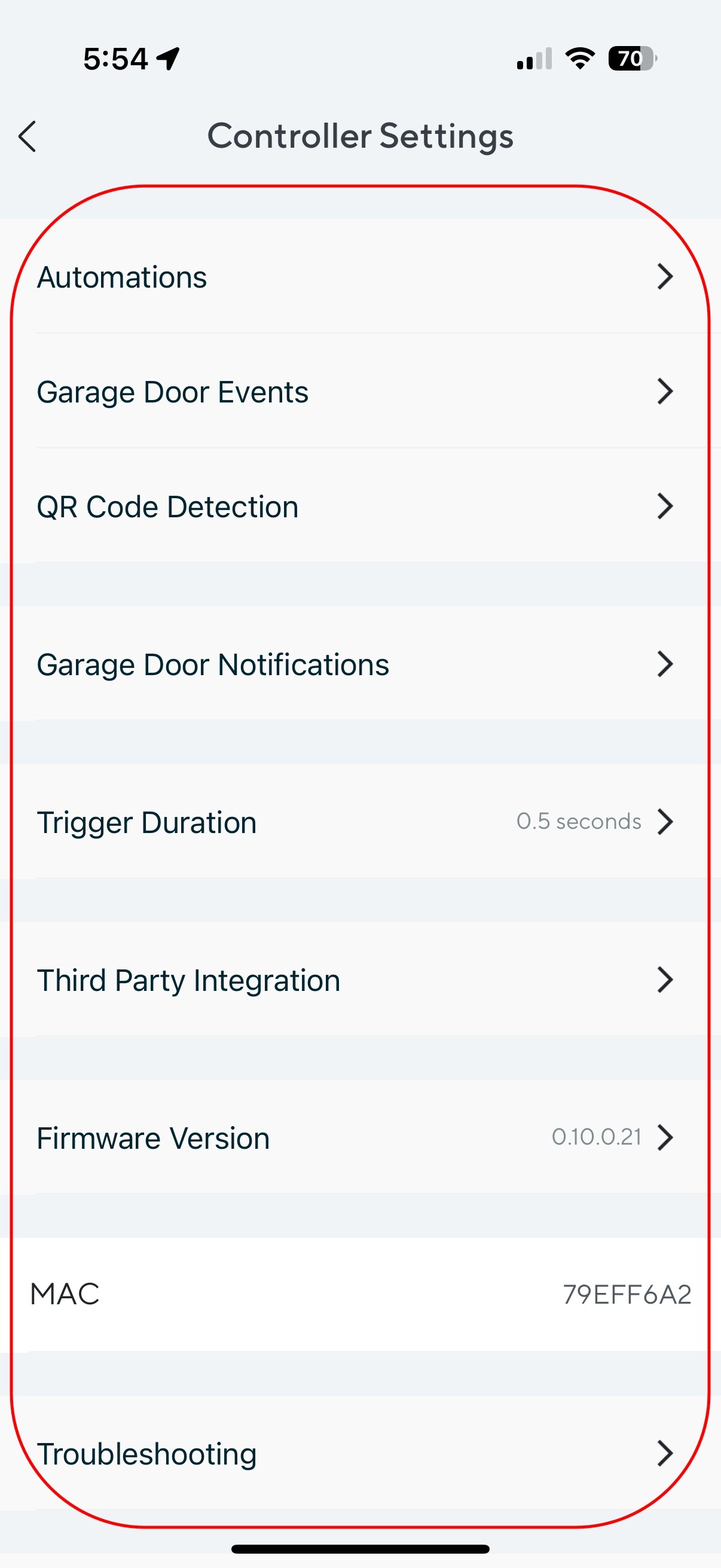

Still don’t see that option. Here’s a bunch of screenshots from Settings:
However I DO see that setting on my other v3 cams.

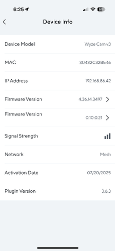

OK First off let me say thank you thank you thank you for just automatically posting the screenshots. I can’t say how much that helps. And this is A V3 that came with the controller?
You didn’t replace it with a separate V 3 or maybe an older V3? I don’t remember if the dusk or dark setting was a firmware option or if it was camera model specific when we did slight upgrades on the back end for the V3 models.
Considering how ahead of the game you already are could I potentially ask you to post a screenshot of your device info page? I have so many questions now
Yes.
Here it is:
As a bonus, here is the settings and device info from a v3 that I bought in 2022:
Frank
You have to set night vision to “auto” before the dusk/dawn option will show up, it uses that setting to choose when to automatically switch. When in manual it won’t be there.
It’s because they don’t have it set to “auto”, that option only comes up in auto mode.

So I set the night vision to Auto then set the condition to Dusk.
It went to purple.
I turned on the lights and it was normal.
I turned off the lights and it went purple again.
I noticed after turning off the lights that the purple was pulsing. It wasn’t doing that before I turned on the lights.
