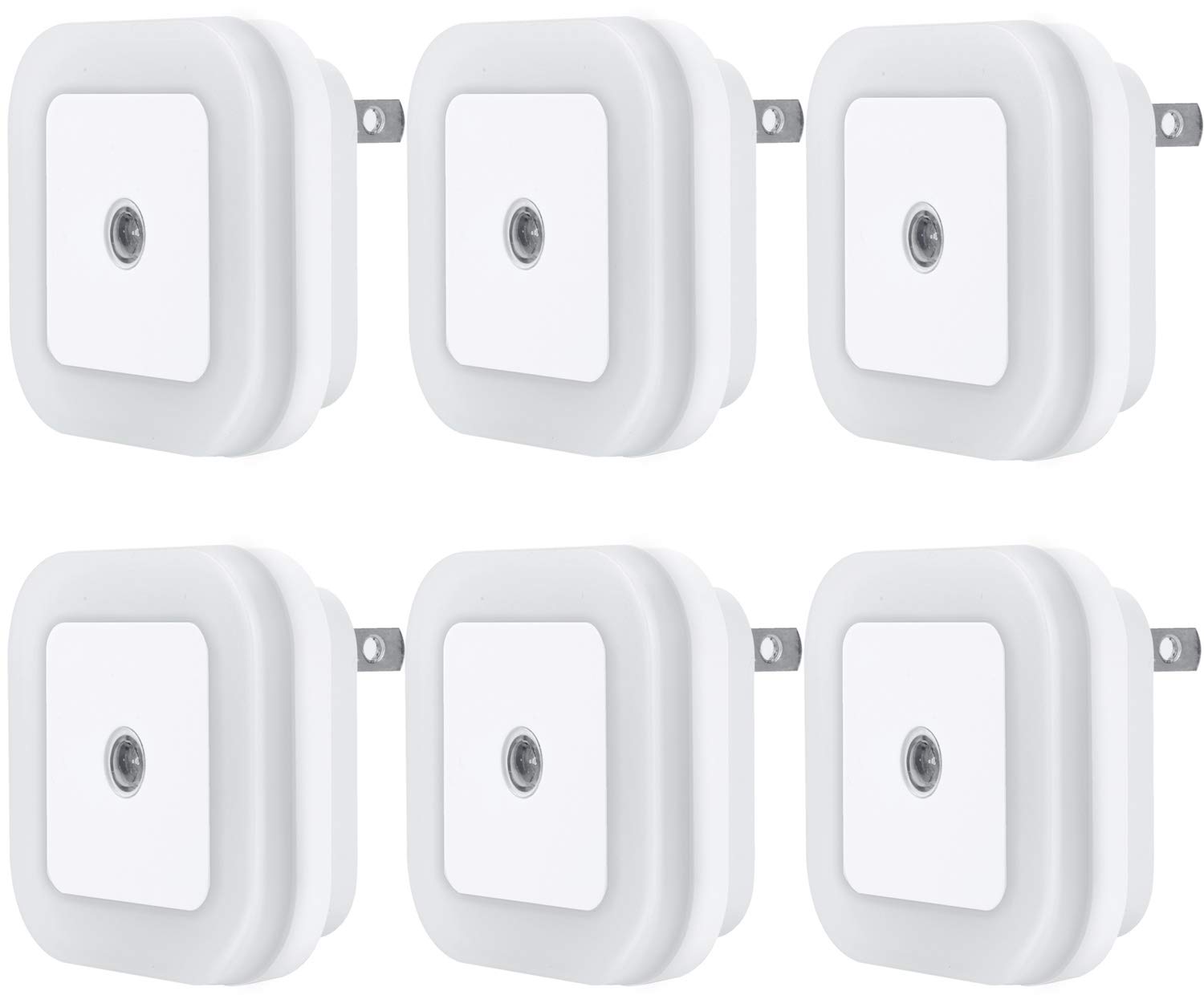

How about leaving Night Vision completely Off? You could try a couple of LED night lights plugged in around your garage to see how video looks when the sun goes down. Here are 6 night lights for $6.99.
