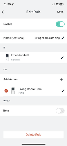

I set a rule to have the v3 pan “ring” when my doorbell pro is pressed. I get all the notifications on my phone that the button is pressed, my chime rings but my v3 pan doesn’t ring. I power cycled it too and restarted the app. What am I doing wrong?

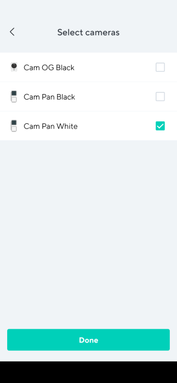

Did you try it without using a rule? The way I made a Cam Pan v3 (and Cam OG) ring was to enable it in the doorbell settings. I don’t have the Video Doorbell Pro; I have the Video Doorbell v2. I would expect the settings to be similar, but I’d have to rely on input from someone with a Video Doorbell Pro to be sure.
For the Video Doorbell v2, from the app’s home screen, I tap on the Video Doorbell v2 > Settings
> Chime > Cameras as Chime to get to a “Select cameras” screen. On that screen, I can check the boxes beside the cameras that I want to act as accessory chimes.
Thanks, I am trying to do it using rules since it’s my only option. I attached the screenshot.
My doorbell pro doesn’t have the chime options that you mentioned so I can’t do it through doorbell pro settings.

I get that. I haven’t actually tried that, but I’ve seen those options available in Rules. I was sharing the way I did it because that’s what worked in my own testing, but I don’t have a Video Doorbell Pro, so I’m aware that your experience may be different.

I’m not aware of a way to adjust that in Rules or the settings for a given camera, which is another reason I think having a consistent way to manage this feature within the app modules for all of the doorbell models makes sense. When I want to select a camera to use as an accessory chime for the Video Doorbell v2, I can navigate to this screen:
There I can tap Cameras as Chime to get to the next screen, where I can select which cameras I want to use:
