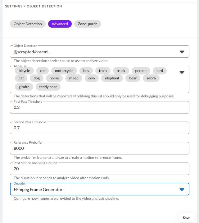

Naw, there are actually several totally free docker containers you can use to do your own detections from camera streams. Lots of them will even run on something as affordable as a Raspberry Pi or any old computer. Then use something like Scrypted or Docker Wyze Bridge or another similar container to grab the RTSP stream and feed it into one of the free image detection dockers. Lots of people do this for Home Assistant to have their own detections. Some of them have a ton of animal detections already built in. For example, if you run Docker Wyze Bridge into Frigate, you can have the following animals already detected:
  • bird
  • cat
  • dog
  • horse
  • sheep
  • cow
  • elephant
  • bear
  • zebra
  • giraffe
and many, many more detections…all free. And if you just run it on an old computer, no hardware cost either, otherwise EASILY just buy an old R-Pi or similar for under $50.
Anybody could do all that right now with their webcams if they don’t want to wait for Wyze to implement something.
I’d say cost is nothing to max of $50, and time will really just be a few hours or so. give or take a few hours depending on your level of understanding or experience with docker containers.

So, with scrypted, you go far, far beyond confidence interval. You can bypass the camera’s motion sensor altogether (with wyze specifically, you actually have toemphasized text**) and it’s a whole new level. You have motion detection settings like Wyze has in their backend development, but YOU get to fine tune it perfectly for you. There are unlimited zones. And they can all be set differently in one camera:
My bird feeders zone has settings that literally just detect bird sized things from pretty far away, and the the aforementioned object detection (all of this is just MOTION), it’s pretty amazing. In this example by fence isn’t a motion zone, it’s set to “observe” – it’s a motion sensor – that’s it, for the fence. And then porch has completely different settings as well. And again, this is ONE camera, not three, as it may appear by looking at settings alone.
Not only that, but you have at least three different Motion Detection plugins to choose from; however, ultimately, it’s not much of choice, you’re going to go with the best that your system can handle (OpenCV, PAM Diff, Webassembly, WebGL, etc), all slightly different settings and levels of power.
And then you have your Object Detection, again, unlimited zones, and they don’t have to be the same, in fact, they are completely separate, unless you want them to be the same.
You don’t HAVE to do this for every camera, but you sure can go crazy if you want to. And with scrypted NVR everyhting is 24/7, so, say goodbye to those SD cards, you don’t want them, they just get in the way.
