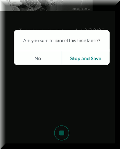

On my iPhone running Wyze App Beta 3.7.5 (3) I was able to set a timelapse on two of my v4 cameras, leave that screen, return to the Timelapse page, I see a “Stop” button down below.
On my ‘ancient’ Galaxy Note 8, running Wyze App v3.6.7 (694) on the 3rd v4, I did the same, and upon returning to the Timelapse screen:
If I click on the green button below:
So I assume the timelapse is still running.

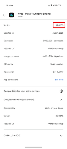

That’s an interesting observation. You’re right that 3.7.5.697 isn’t reported in the Play Store:
It is oddly what’s reported by Android:
I appreciate the screenshots. :+1:
