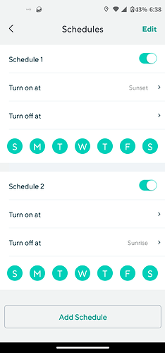

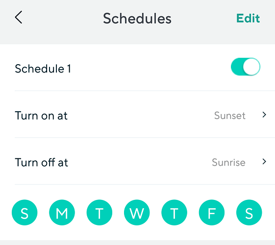

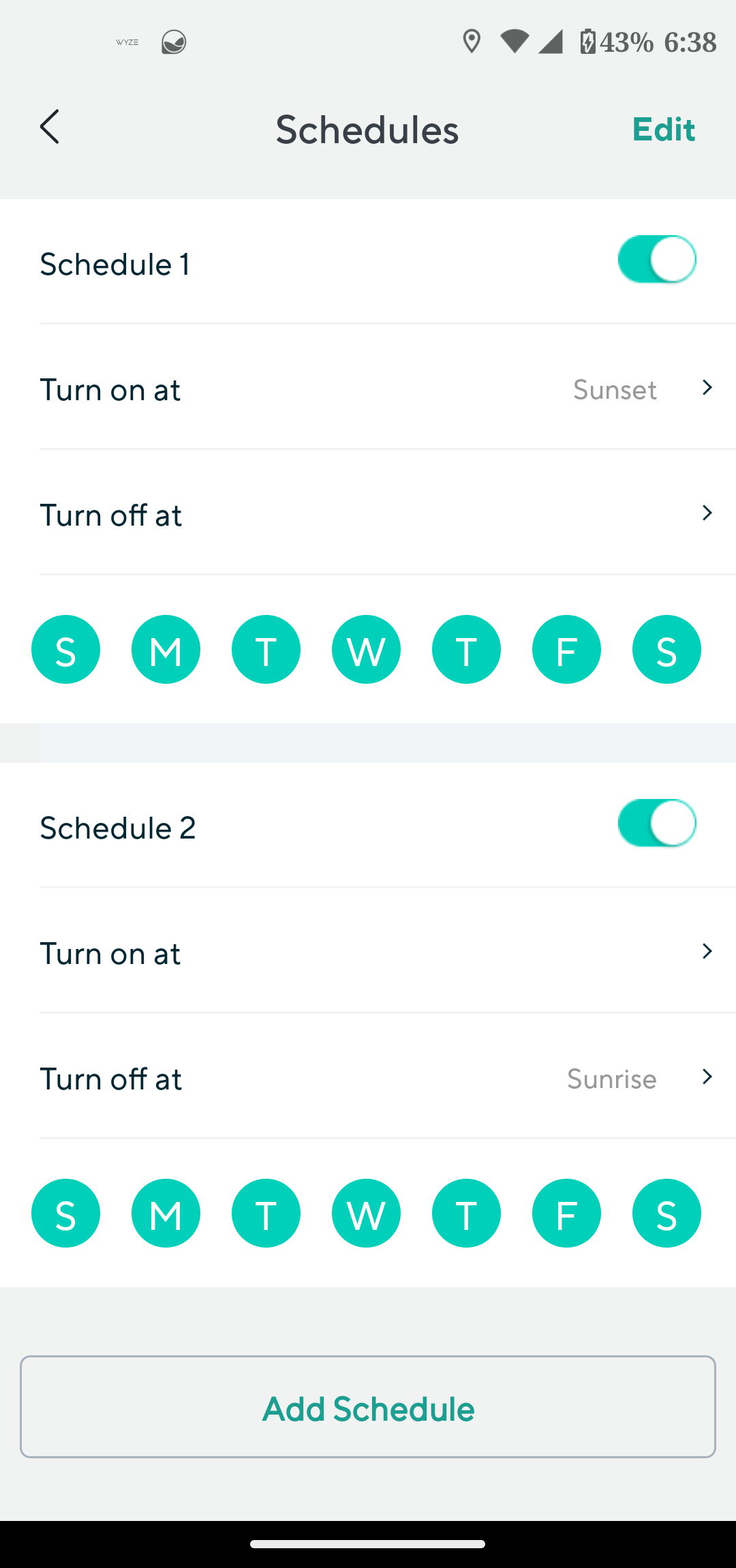

I also recall helping another user who was having the same issue you previously had with scheduling on\off within two different days. But, there has been an update to the FW scheduling, so that may have been fixed. If it was fixed, the first schedule image should work. If not, the second image splits the on\off action into two schedules.

Have you considered doing both?
Here is my thinking. Redundancy is a good thing.
So on the one plug we were working with…the lamp post plug:
  • At sunset, both the RULE and the SCHEDULE turn on the the plug. First one successful wins. The second one, since it is already on, is just a redundant on command that does nothing since it is already on. (You could even modify the rule to make the on command x minutes before sunset so they aren’t triggering together.)
  • If the plug is offline, the SCHEDULE is the fallback safety to turn it on.
  • 59 minutes before sunrise, the RULE turns it off.
  • At sunrise, if the RULE failed to trigger because the plug was offline, the SCHEDULE turns the plug off. It is the fallback safety an hour after the RULE in case it didn’t execute.
  • If the plug WAS turned off by the RULE, the schedule turning it off again will do nothing at all. It is a redundant command. The plug stays off.
So… The Rule is the primary, the schedule is the backup.

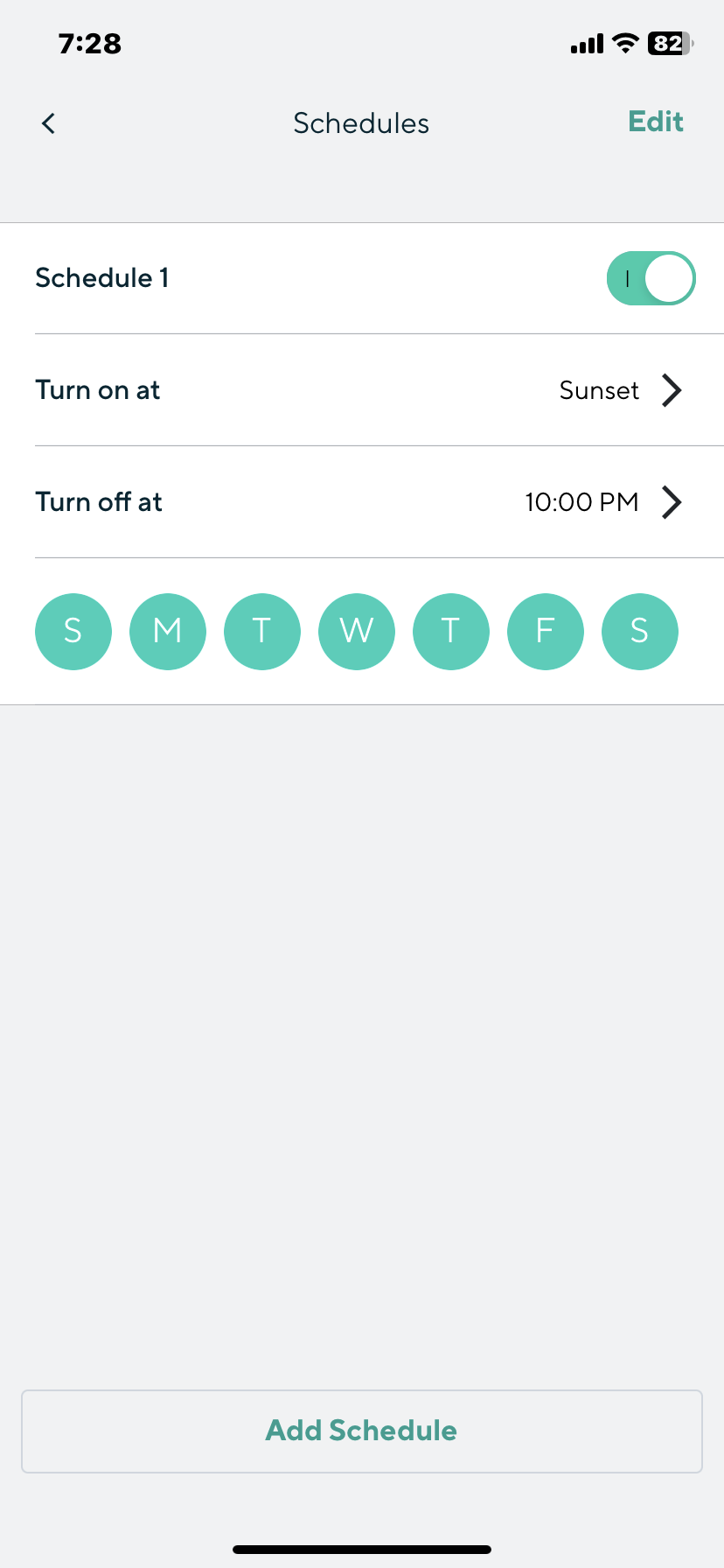

I like your suggestion for using both Rule with Schedules as a fallback. I’m going to take it 1 step at a time. Today I set schedules for All my plugs and will post screenshot below;
1st screenshot is for my "standard” plugs
2nd is for my Special plugs.
Also, I have disabled Rules until I get the scheduled working. Do they look correct to you ?
Im not seeing any issues. You will just have to monitor their behavior to see that they are doing what they are supposed to do. If any of them don’t act right, you can always try splitting the on and off into two schedules in the same plug.
