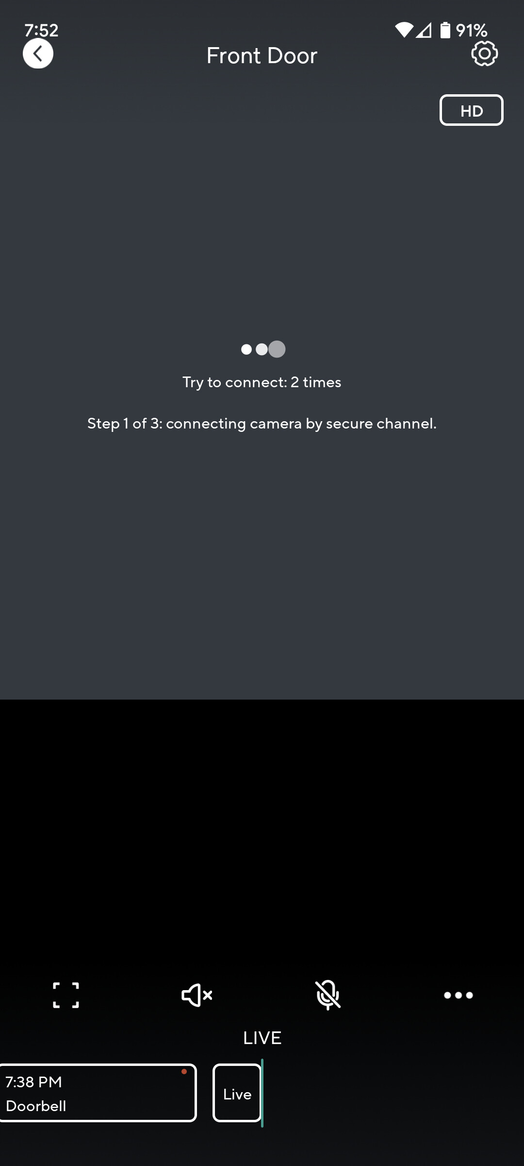

Also to answer your question, Yes ever time I cannot get by step 1 of the connection process. Worked perfectly until now. :slight_smile:
Here is an image:
That’s interesting, I was going to try and replicate this for you but I don’t have an update showing for my doorbell. I have all the other updates V3 and pan V2 and such after the app update today but nothing for the doorbell
