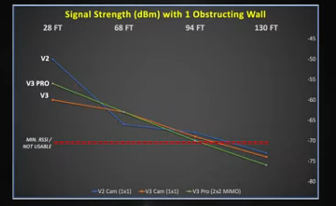

here is a YouTube video on the V3Pro by The Net Guy. At about 14:11 he talks about WiFi

Yep, and he rated the Pro’s WiFi performance as significantly poorer than that of either the V3 (in the middle) or the V2 (best).
His testing and graph showed the Pro better than the V3 out until 68 ft but both below the V2. Then the pro is only slightly below the V3 the rest of the way out in distance until they both become unusable. The V2 drops out quick with distance though and at 50-60 feet, the Pro was the strongest signal of all three cameras.
I’m sorry, you are correct. I misremembered. It goes by quickly but here are his final WiFi rankings.

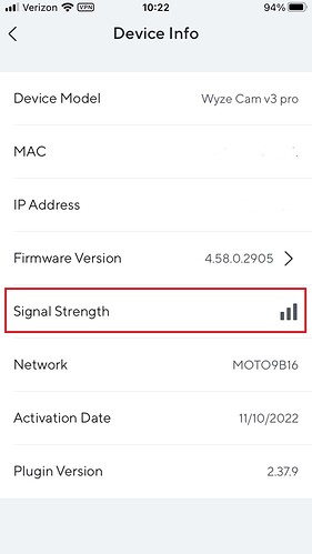

still struggle at SD, but not nearly as bad as 2K
I am not sure which power brick is the correct one at this point. I have them all mixed up. What does the Pro power brick say on it?
2 amp output, not 1 amp.
Okay I switched to the 2 amp one and the problem still exists, but to a lesser degree, I think.
