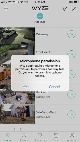

iOS app 2.24.36 update didn’t fix this request to access the microphone once a day when the app is first opened. :unamused:
