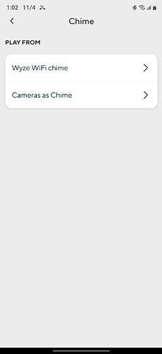

I have to say, I am very disappointed. I am upgrading from Doorbell v2–> Duo Cam Doorbell. After installation…I found that in the software, there is no option for “My built-in house chime”…I only have the other two options, WiFi Chime or Camera as chime… :frowning:
For those that ask, yes, I still have the Chime Controller from my Doorbell v2 installed. :frowning:

This is what I see in my setting options. For the Duo doorbell.

drum_buster37, you are using iOS.
The people with the option for “My built-in house chime” missing, are on Android.
My app is fully updated and I am a beta user.

Confirmed.
I was able to set “My built-in chime” via iOS…
Also confirmed… The option still does not exist in Android, after being enabled via iOS.

Not via Android right now… If you have iPad or iPhone, you can use that device to set it up.
Oh wow, I could’ve sworn my Android app used to show that as an option, and I went to verify and now all of a sudden it’s been removed/missing. I wonder why they removed the Mechanical chime option from the Android App :thinking:

The VDBv2 still has it. I have one on my garage that is using it, and I checked and see it’s still there.
But when I first got this DuoCDB I saw it for this device as well when I set it up, and now it’s suddenly gone.
Might be because the Duo is battery powered? The wires are supposedly just charging the batteries.
No, people confirmed it works with the Mechanical Doorbell already. Plus it’s still an option on iOS. Plus this article indicates it is supported:
Though it tells people to get the chime controller unit from the VDBv2…but people have reported getting it to work without that.
Hey my android app is also missing the option for the mechanical chime. Fully updated on the beta app, updated camera firmware and nothing. I’ve got the chime controller installed on my chime but not working and I think it’s because the option is missing from the app.
