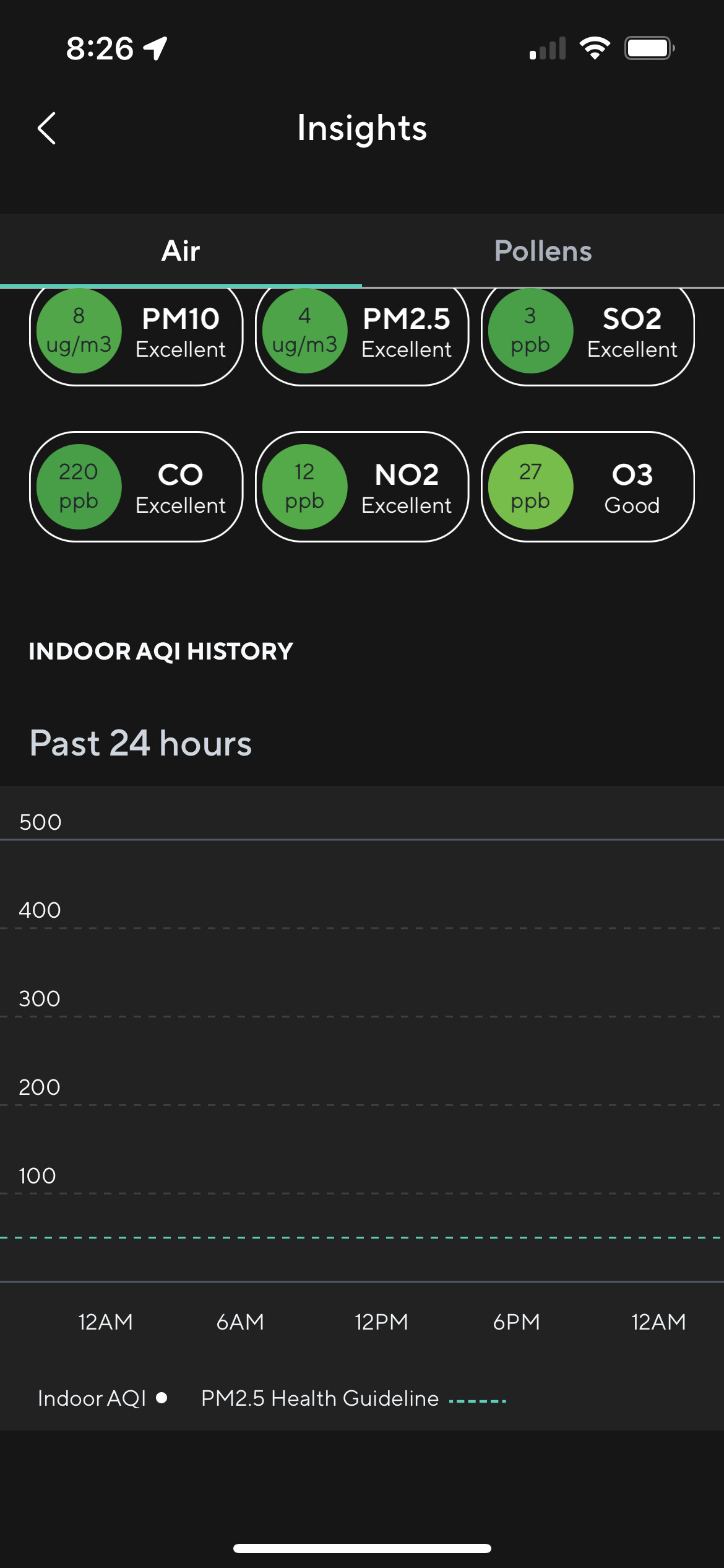

For whatever reason my air purifier isn’t graphing the indoor quality. Log ID 546129

See attached. Firmware is 1.0.3 and I’m using the beta version of the app 2.30.0a7
Have had the filter running for a few days now. Have it setup to switch between auto and sleep depending on the time of the night

I’ve had mine set up since they first shipped, I got it up and running within just a few days of the purifier going on sale. Today is April 30 and for the first time since having it running 24/7 on medium, I got 2 dots to show up. I live in central Texas, Georgetown area. It’s typically always some kind of allergy season around here. The AQI numbers on the front display showed the highest ever since it’s been running, 022. Normally it doesn’t go higher than 005, I actually thought that was the highest it would go. So today it hit 022 and at that time the 2 dots showed up. Maybe??? The air quality is so good (low numbers) that it can’t or doesn’t chart when so low?? Don’t make fun of me for being stupid, it’s just a guess. I’m in process of trying to find out what a good AQI number is. Sorry if I’m way out in right field on this but I was just hoping to share my numbers and charting. I did nothing to the filter to try and fix the charting issue. So when it showed up 3 hours ago for the 1st time I was kinda shocked. Kinda weird that my daughter also came in to ask for Benadryl at the same time I was noticing everything, same time that I had the 022 reading. I still haven’t figured out if that is good or bad but it showed up on the chart. I bumped up 1 speed level to high and within 15-20 minutes the reading on the display went down to a 2, it didn’t just jump to a 2 it worked it’s way down little by little but within 20min. The room size is 30x20 and i had all doors and windows closed. Outside allergy ratings were medium and all the things it’s testing were in green with great as the outside ratings. That all said, everyone in the house today is having a bad allergy day. No complaints on this machine, I’m sure you guys will make this thing better and better with updates. I’m not sure how or what else you can do to it but we are super happy with it. The price compared to several other purifiers is stupid crazy. Your either busting even and the other guys are way overpriced crooks or there is some funny business going on. Thanks WYZE, happy family of customers
After a bit more use, I suspect the air purifier only graphs AQI readings down to a certain level. If the reading is say under 15 for an extended time, no dots. I’ve moved mine to a new room where the AQI seems to hit higher levels and I get more dots. Not consistently, but more. So my guess is the graph just isn’t showing dots under some number for some reason. Otherwise the purifier works great, and at the end of the day this doesn’t really change how I use it, I just like having data!
I think you are correct. I would still like to have dots when it is close to 0. At least that way we know.
