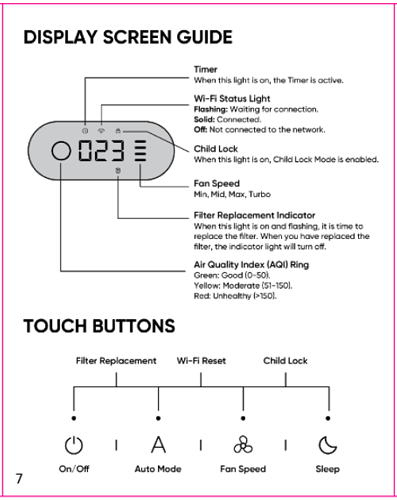

As someone who has made consumer hardware products, we couldn’t get anyone to read the quick start guide either :laughing: The AQI description is there on page 7. That’s where I also found the location of the mystery laser sensor, and the distance required from the wall for it to scan properly.
Doesn’t explain HOW the laser sensor works, but I wouldn’t expect that in a QSG.
