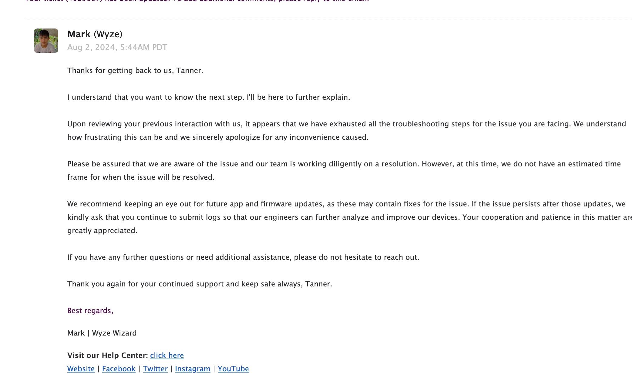

I got a reply from the Wyze support. RE: fail error when going into the chime screen
[Mod Note]: Personal information in file name of attached graphic has been redacted for privacy and security reasons.
Yeah, I am in the same situation as tanner - I have submitted logs and screen grabs to Wyze support and they are investigating. It will be fixed when it is fixed.
