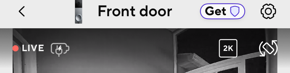

It would be nice to be able to see the battery percentage somewhere in the app. It seems like I would have to turn off power at my breaker to see what % I am at right now.
It seems to, at least according to screenshots I’ve seen:
Maybe you need to tap the view pane on the Live Stream screen to get the overlay that displays it?
Agree @Crease. The battery icon has a plug with a lightning bolt overlayed on top. Only visible when you tap the live view screen.
Sorry if I am derailing thread here… but this is what the latest version of iOS Wyze App shows me while in live view.
Same as Android when you tap the screen. While no battery charge percentage, the icons are telling you that the duo is hardwired (the plug) and is actively charging or is charged (the lightning bolt). I have yet to see the lightning bolt disappear as a sign the battery is 100% charged. I seem to recall reading somewhere that there is protection in the battery and charging is stopped when capacity is reached. Shouldn’t have to be concerned about overcharging and decreasing lifespan of the battery.
Although tripping the breaker will make the percentage appear in the battery icon, it has always come up as 100% for me verifying that hardwired will maintain the battery at 100% and there is no need to worry about the duo battery losing it’s full charge. Provided it has been properly connected to a transformer for the purpose of charging the battery since it is essential to the operation of the duo.
