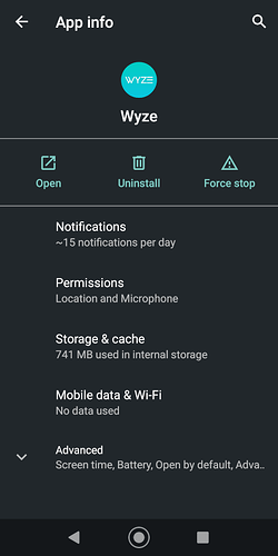

That’s frustrating. I would guess at least part of the reason is that you’re using a Samsung device (at least it appears so based on the bottom navigation bar in the image you included) with the changes Samsung makes to Android on their devices. This is what I see on a Motorola moto g7 running Android 10:
This is what I see on a Google Pixel 4a running Android 13:
As I understand it, both of those are near-stock Android. One of the things that I really like about Android is that it allows a lot of freedom for customization. The flip side of that means that individual device manufacturers often build their own changes into the operating system itself, which means that Android versions of the same base number aren’t really always the same (i.e., it’s not the same type of consistency that iOS users expect to experience).
Just to continue to share the difference, back on my Android 10 device, if I tap the Notifications line on the App info screen, I see this:
Then if I tap the first WyzeMessage line, I see this:
On that screen, I’d then tap Advanced to expose Sound where I could tap to make a sound selection for notifications.
