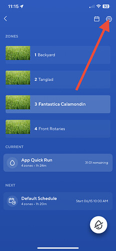

Follow these steps to fix the issue:
-Click the gear icon
-Tap on System
-Tap on Sensor 1 and/or 2
Just make sure to set the Rain Sensor to “None”
That’s it! Your unit will follow your set schedule from this point on.
Hope it helps everyone. Thank you.
