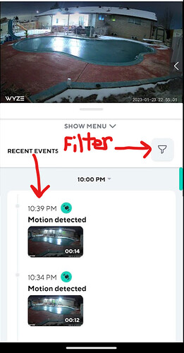

  • I can view the most recent events from the live stream page, and even filter to only see the events I want (ie: person detections or whatever other limits)

Do you mean the live view after clicking into the camera?
how do you do that? is it just OG feature?
i don’t see any way to view events from there. I can see playback of my SD card, but no events.
Am i missing something? v3 w/ can plus.
I expected a “events” list, or at least a link to events only from that camera that i clicked into. Going through the events tab and picking one camera at a time has been a pita.
Yes, on the V3 Pro, Pan V3, or OG. The newer cams have this, the older models don’t yet have this new interface, but Wyze has indicated that if people like it then they will consider updating the rest of the cams to do this too.

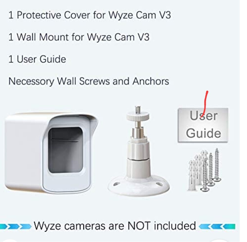

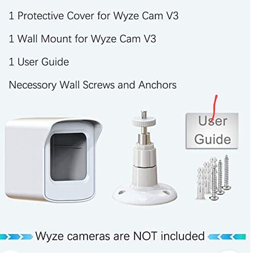

Here is an alternative I might try using, it says only Cam V3, but I think the OG Cam will fit:
PEF Mount for All-New Wyze Cam V3 ONLY, Weatherproof Protective Cover and 360 Degree Adjustable Wall Mount Solid Housing for Wyze V3 Outdoor Indoor Smart Home Camera System (White, 2 Pack)
Or use link: https://a.co/d/4YrDn0v
Keep in mind that the OG is slightly smaller than the v3. You might have to add some padding so it doesn’t wobble inside.
Thank you! I’ll update my experience after I try it.
We just bought a few V3 white outdoor i closersthere cheap,and ordered more today,the camera is a little smaller we used 3m sticker patch, and worked great
Then we used the 3M sticker to make it fit just right

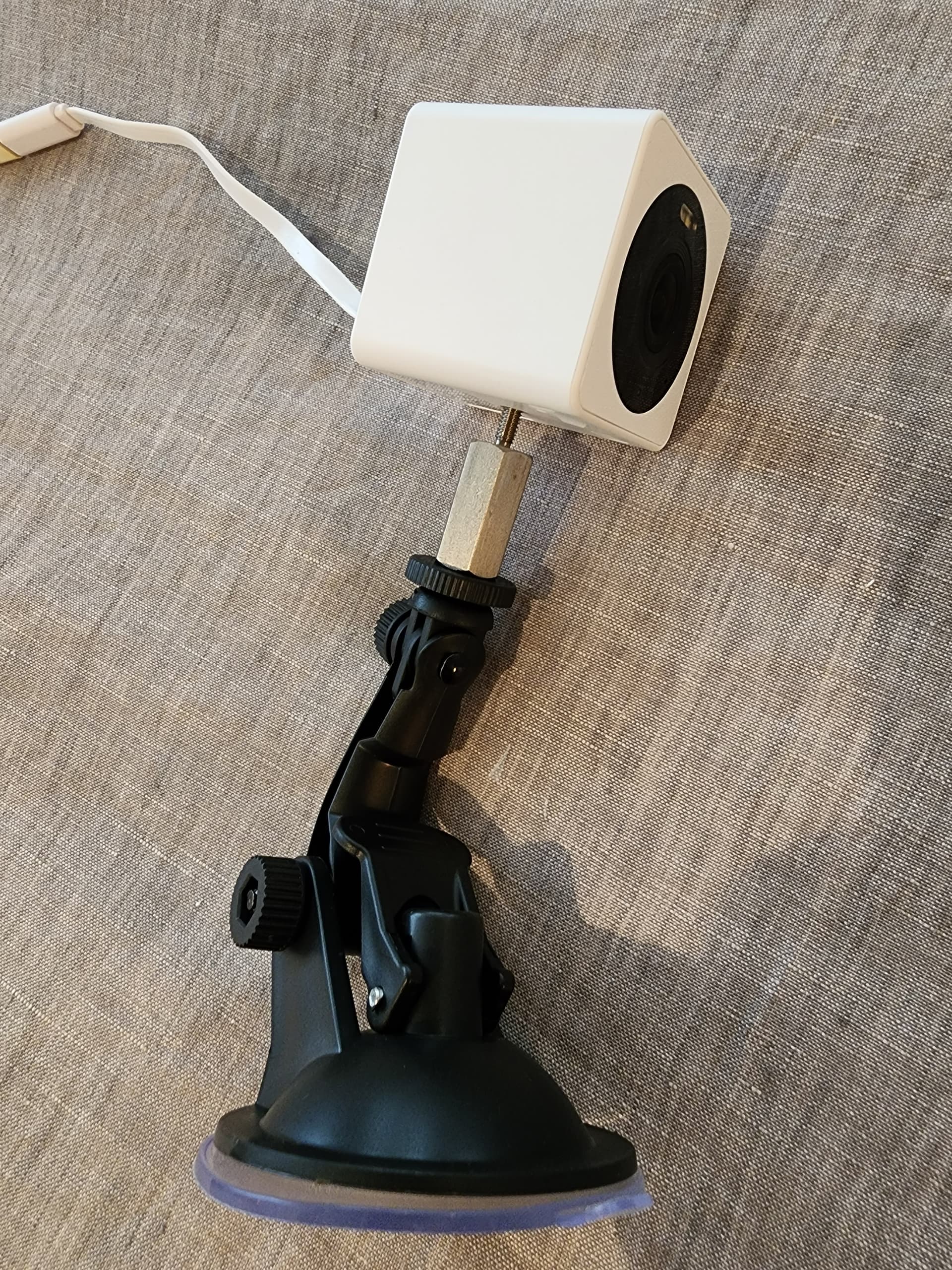

Quick update: I ordered the adapter referenced in my OP. So far, so good. Only issue is that it does increase the distance between the mount and the cam by about an inch, which may be good/bad/meaningless depending on your use-case. Oh, and it adds about 40% to the cost of the OG cam :frowning:.

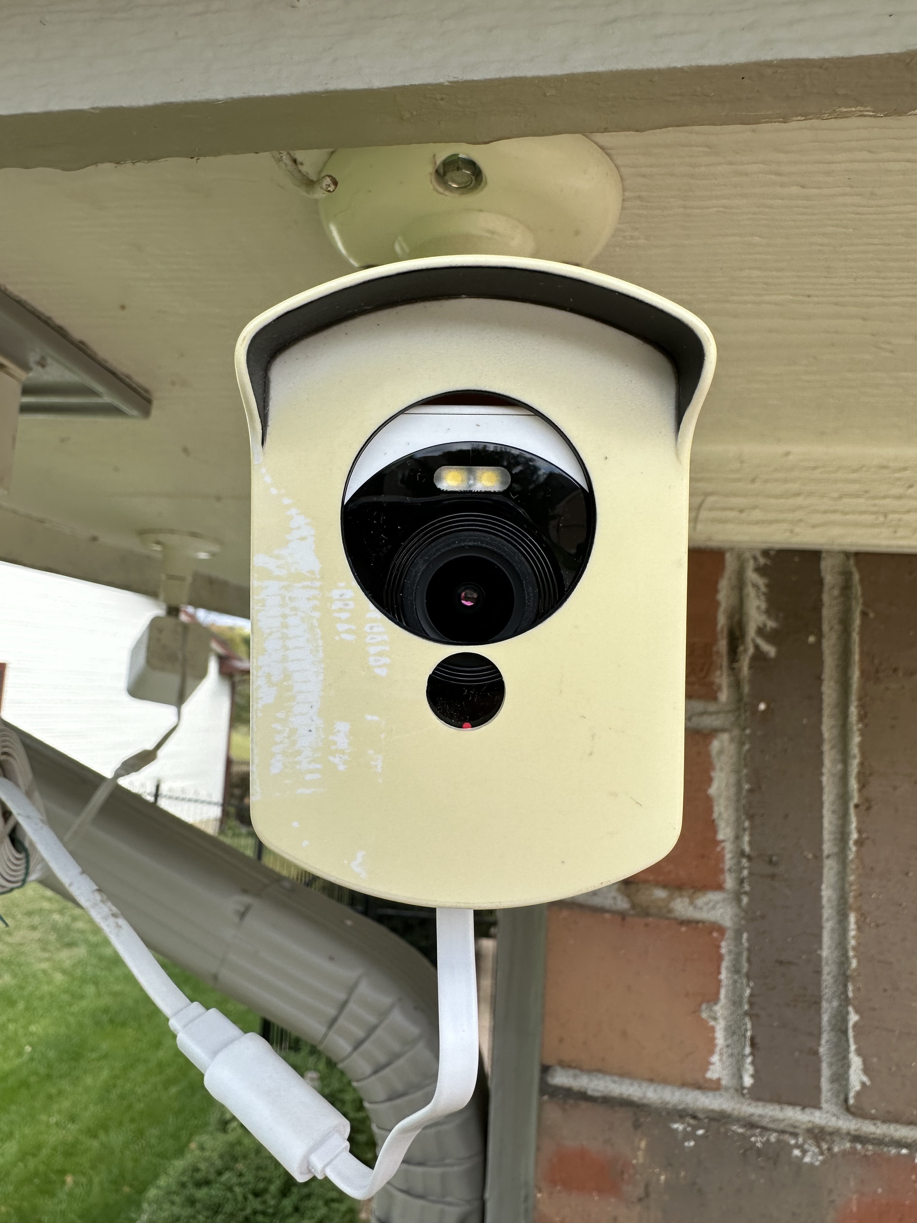

I was totally unaware of a mount change when I ordered two OG cameras to replace a couple of V3 cameras that have gone “starry” in the night shots. (No amount of cleaning the outside lens fixes the star rays that show up as a halo around lights.) So now a quick swap suddenly means a whole lot of work and more holes in my house. I have some old V1 camera enclosures that use the standard size mount and they worked! The camera doesn’t fit in the enclosure exactly like the old…it’s a little mis-aligned around the lens, but it isn’t a problem. It looks like the enclosure might be cropping the bottom of the picture, but it doesn’t. I might go back and see if I can prop up the camera inside the shell to raise it, but since it’s not causing a problem I’m not sure it’s worth another trip up the ladder.
