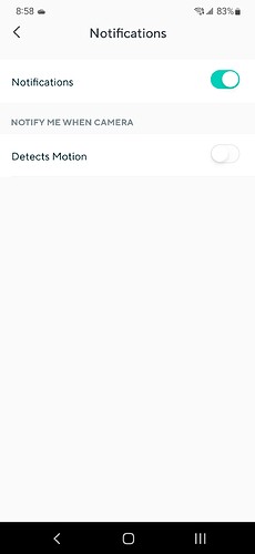

Send a screenshot of the notifications page in your doorbells settings > notifications
Turn off your notifications for Detects Any Other Motion and Wyze AI Events and turn on the VOIP in the App Push Notifications settings.
@IEatBeans, thanks for the response. Attaching requested app > video doorbell > settings > notifications screenshot.
@SlabSlayer, thanks for response. The app > account > notifications > push notifications > video doorbell > notifications screen is identical to the app > video doorbell > settings > notifications screenshot shared above with slabslayer.
That is to say it only has a “notify me when camera” > “detects motion” option not any “detects any other motion” and “wyze ai events” options. Perhaps you have those options because you are enabled with the enhanced fee based services,

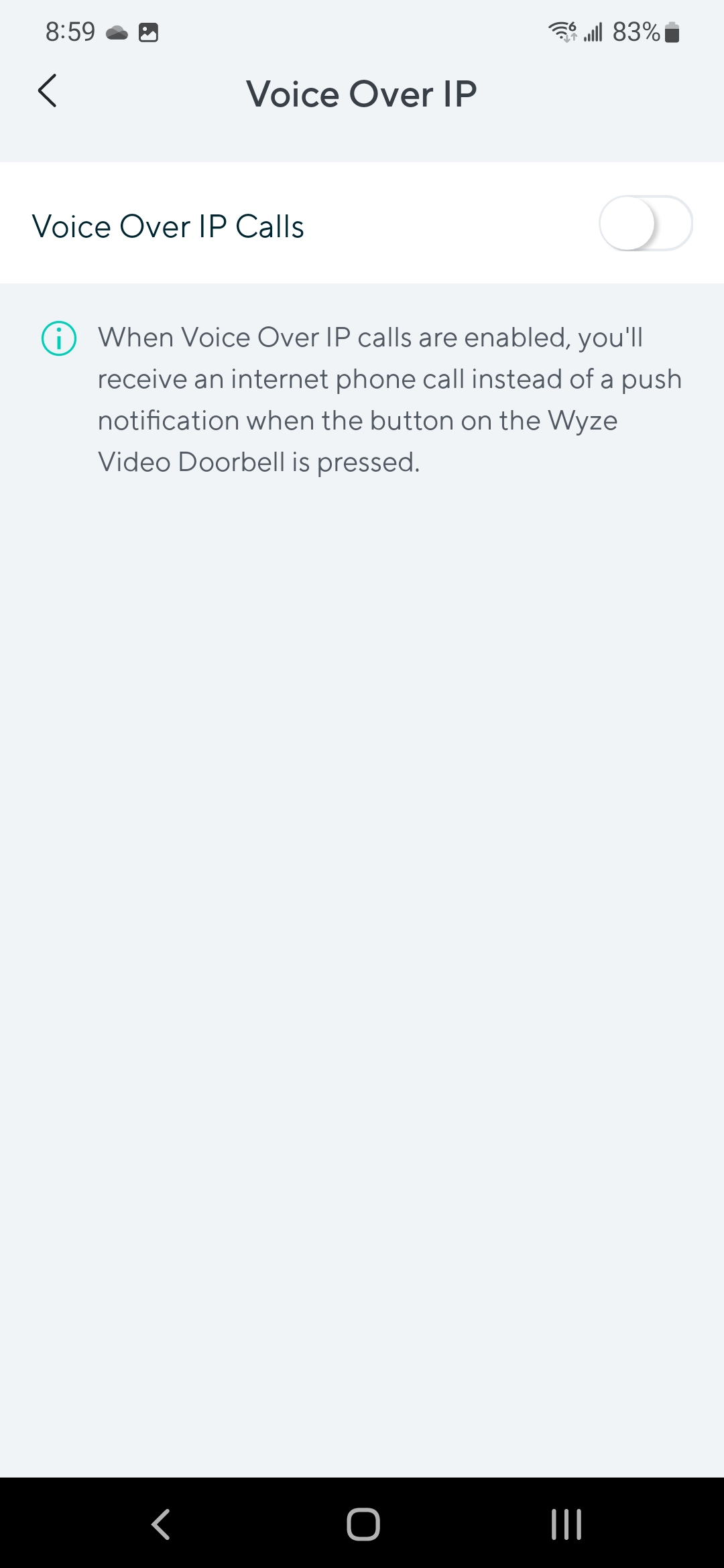

In the app > account > notifications > push notifications > voip screenshot i’m attaching it denotes that this only applies to when someone rings the doorbell. What i’m looking to disable is push notifications when motion is detected. I’m fine with receiving them when someone rings the doorbell in lieu of a voip call which i find disruptive, especially if i’m in the middle of a meeting.
With your notification settings as they are, you should not be getting push notifications when the cam detects motion and records a 12s video to the Events tab … Provided it is working correctly on the Wyze server end.
Understand your desire to not use VOIP. Should have no effect on your push notifications.

Disable this one to for motion notifications.
Shouldn’t effect notifications for the button press. Test it and try it out.
@Omgitstony, thanks for response. That fixed it.
