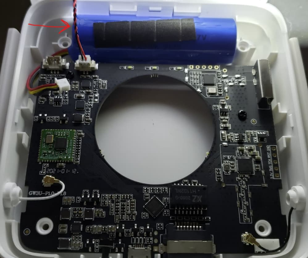

Any sense on mAh rating and whether it’s replaceable or not? There isn’t a compartment door, so obviously I’d have to open the chassis… Just curious as to whether it’s a common battery type or proprietary?
I just purchased the new Wyze Cam and garage door controller. While more complex and costly than the old door sensor that is no longer available on a stand-alone basis, it allows me to check if my garage is open or closed as well as operated the door remotely. Moreover, i do not need to sign up for the Wyze monthly home security service.
It’s a 2600mAh battery. Looks fairly standard and easily replaceable:
Thanks, that was some above & beyond service!
And u jogged my memory about this discussion last year. Pretty sure u or another maven mentioned the 2600mAh which is perfect for this application… :sunglasses:
That’s what we’re here for. :slight_smile: Happy to help. :+1:

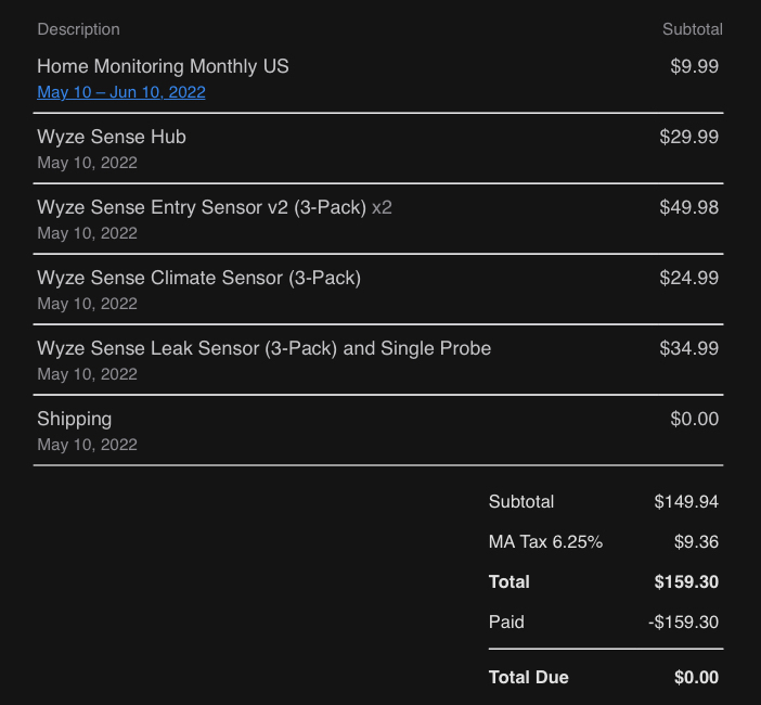

I broke down and bought the V2 (build your own)
I cancelled the home monitoring right away. Hopefully no unexpected charges next month. Fun awaits me at the mailbox in the near future.
