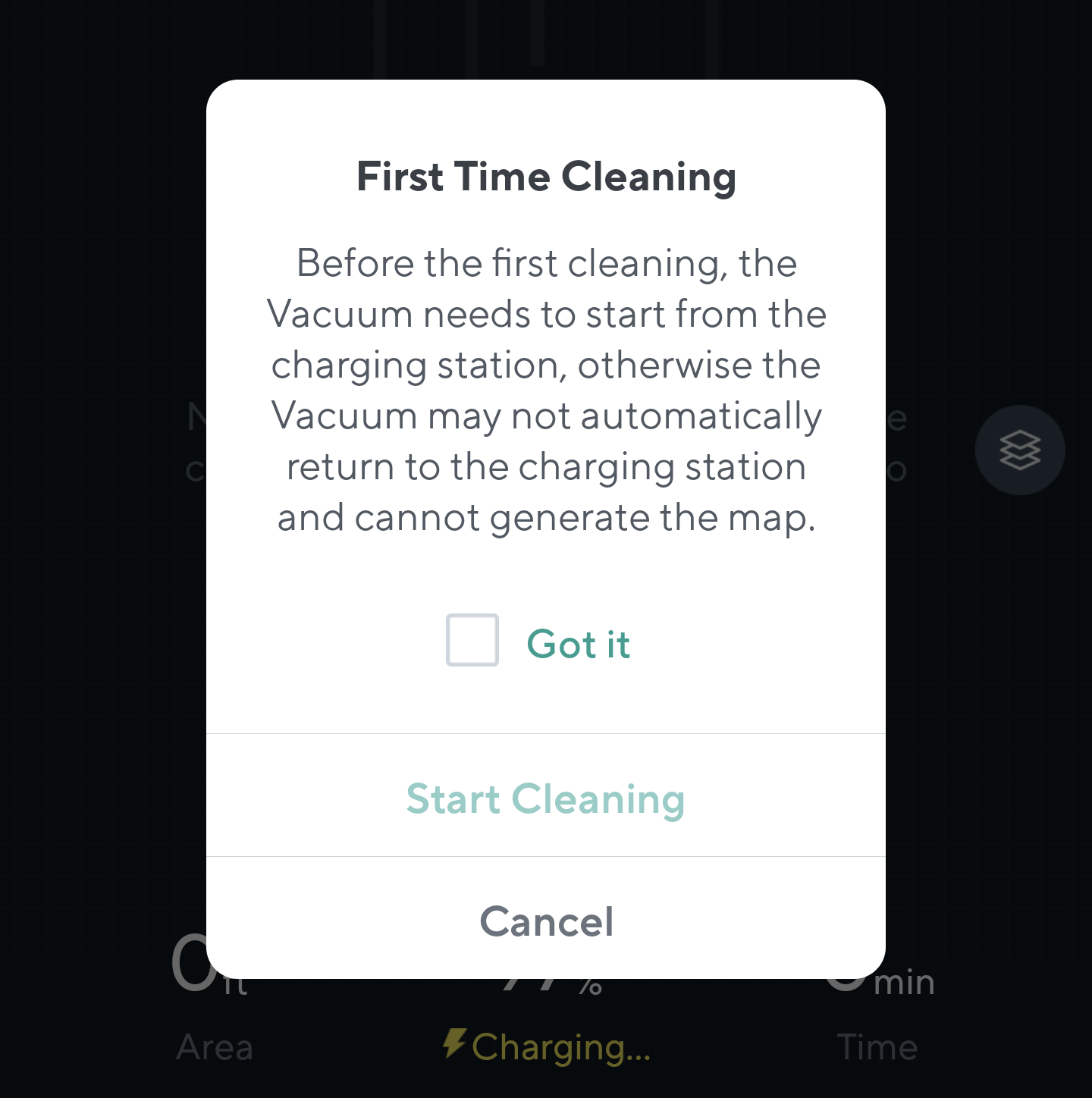

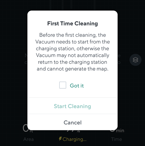

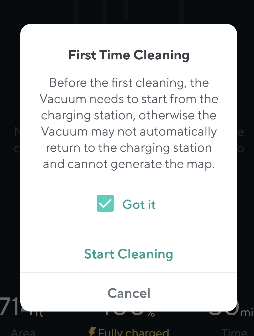

@WyzeJasonJ do you have any suggestions? I tried it again today at our church, basically I can map the whole thing out, but as soon as it returns back to the charger it goes back to wanting to quick map it again.
