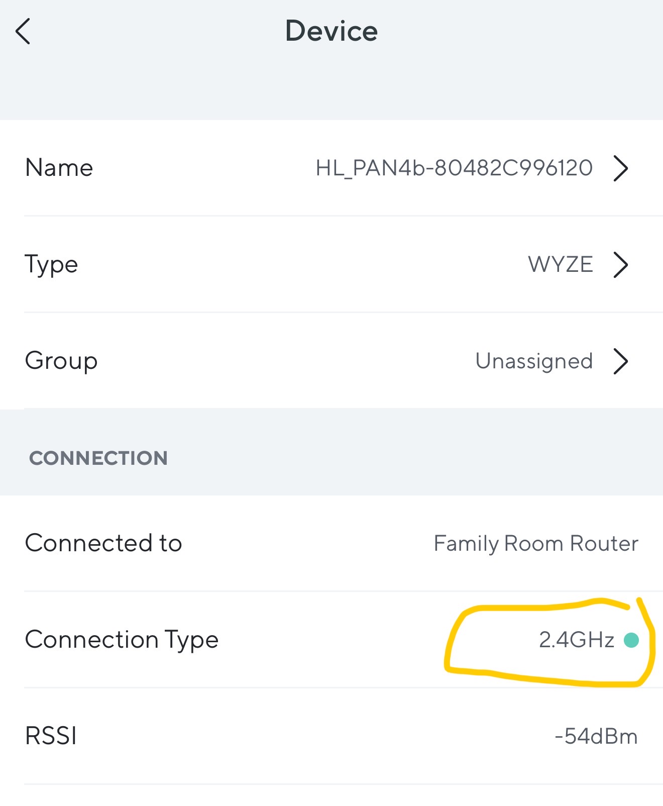

Maybe it is connecting with the 5g, and that signal is too weak where it is at, and you should force it to 2.4G which has a longer range?

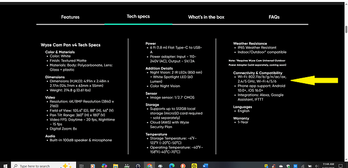

Your Wyze Chime and Cam Pan V3 would be connecting to your router using 2.4GHz band because that is all it is capable of. 2.4GHz band is better at penetrating walls and obstacles, but less bandwidth compared to 5GHz.
Cam Pan V4 is compatible with 2.4GHz and 5GHz band. It is possible that your router is connecting your Cam Pan V4 via 5GHz band instead of 2.4GHz. Try to find a way to split the bands so it forces to connect your Cam Pan V4 via 2.4GHz if range is an issue.

Its on 2.4G. After multiple resets, removing the camera and re-attaching it (which took several attempts, repeatedly failed to get “ready to connect”)
