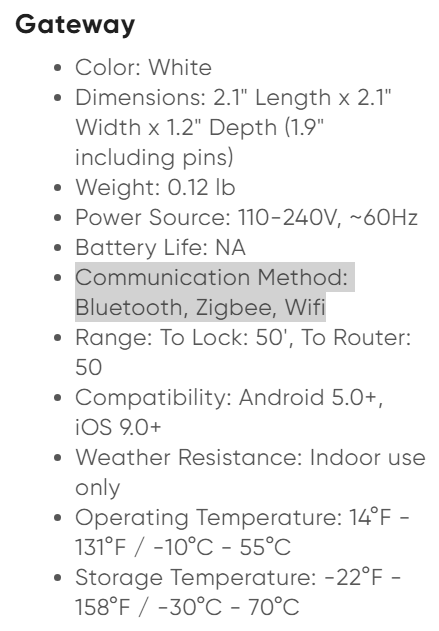

Correct! I do have a bunch of these. As I understand it, the lock gateway uses Bluetooth for pairing/setup, connects to the router by Wifi, and then connects to the Original Lock through Zigbee, but non-standard.
@haticK This means it’s pointless to leave the Lock Gateway plugged in unless you are using the original Wyze Lock. It is not used for anything else at all. It would just be a waste of power and signal interference for no reason.
Since I don’t have this, I looked up the same things on the product page and also saw under Wyze Lock Details that it lists this:
  • Communication Method: Bluetooth, Zigbee
Based on that, I surmised that the Lock communicates with the Gateway via Bluetooth and/or Zigbee (maybe it’s Zigbee and the Bluetooth connection is for doorbells? :man_shrugging:), so it seemed reasonable to believe that the Gateway was no longer needed if the Lock wasn’t being used. Thank you for confirming. :+1:
Not to mention sucking up an IP address and using network capacity that could support other devices you’re actually trying to use, eh? (This is coming from a guy who needs to build a better network.)
that one I belive is correct. Although not confirmed via anyone official but I think we utilize both depending on the situation for whatever is best utilized as currently I can connect my doorbell to a lock on one of my back doors that is outside of Bluetooth range especially with obstructions but it would make sense that zigbee would work here. This is unconfirmed and it’s something I have not had a opportunity to present to anyone to get clarification on yet.
I can clarify some of this. For one thing, an employee explained this in the past, that the original lock integration goes through WiFi, not Bluetooth or Zigbee. But even without that:
  • The Doorbell to Original Lock integration works with Doorbells that don’t support Bluetooth (Original Doorbell) or Zigbee (all doorbells).
  • The Lockbolt uses Bluetooth but can’t use the same lock integration because the Lockbolt doesn’t support WiFi, and we were told it only connects to the VDBPro through Bluetooth.
  • I know definitely Zigbee is connecting the Gateway to the Lock (a dev discussed this in the past as well).
Wyze built the Original Lock integration to work with WiFi. I also know that the Palm Lock Integration with DuoVDB runs through the Rule Engine (cloud control with preset trigger/action attached to the GUI button as a shortcut), and I suspect the same is true for the original lock (that it is also controlled through the Rule Engine). Lock Bolt integration to VDBPro is not controlled through the Rules engine though since it doesn’t exist in the rules engine since it doesn’t have WiFi.
