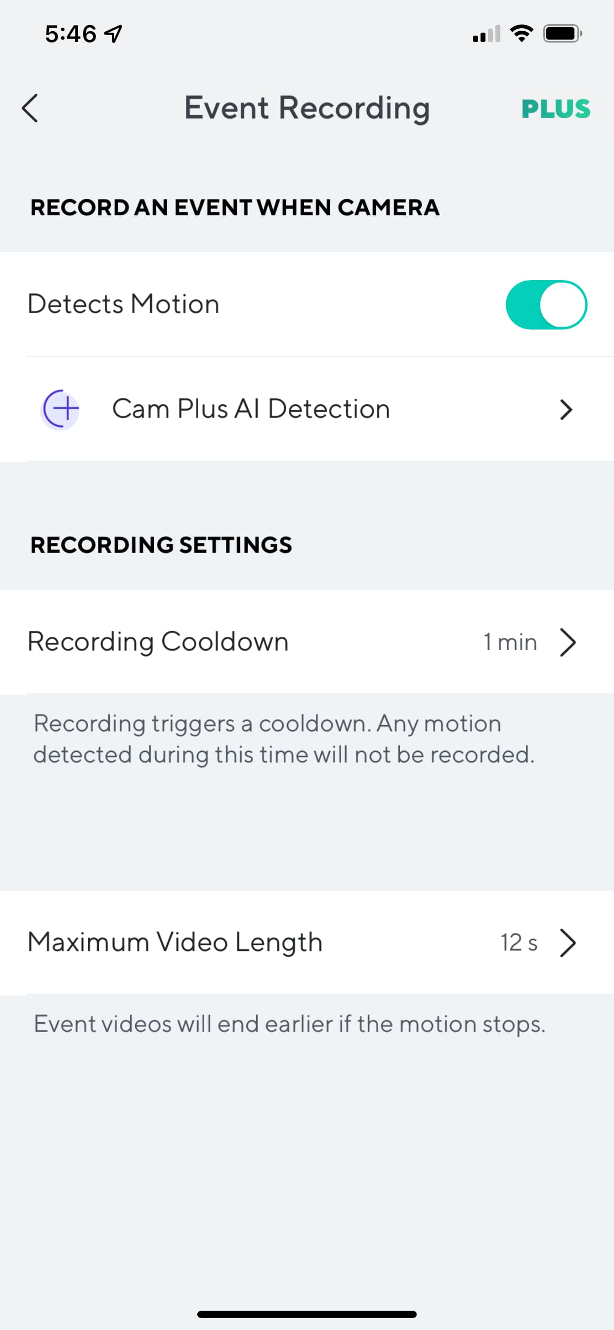

for event recording, detects motion, ai detection includes person, package, vehicle. with 1 minute cools down and 12 s recording.

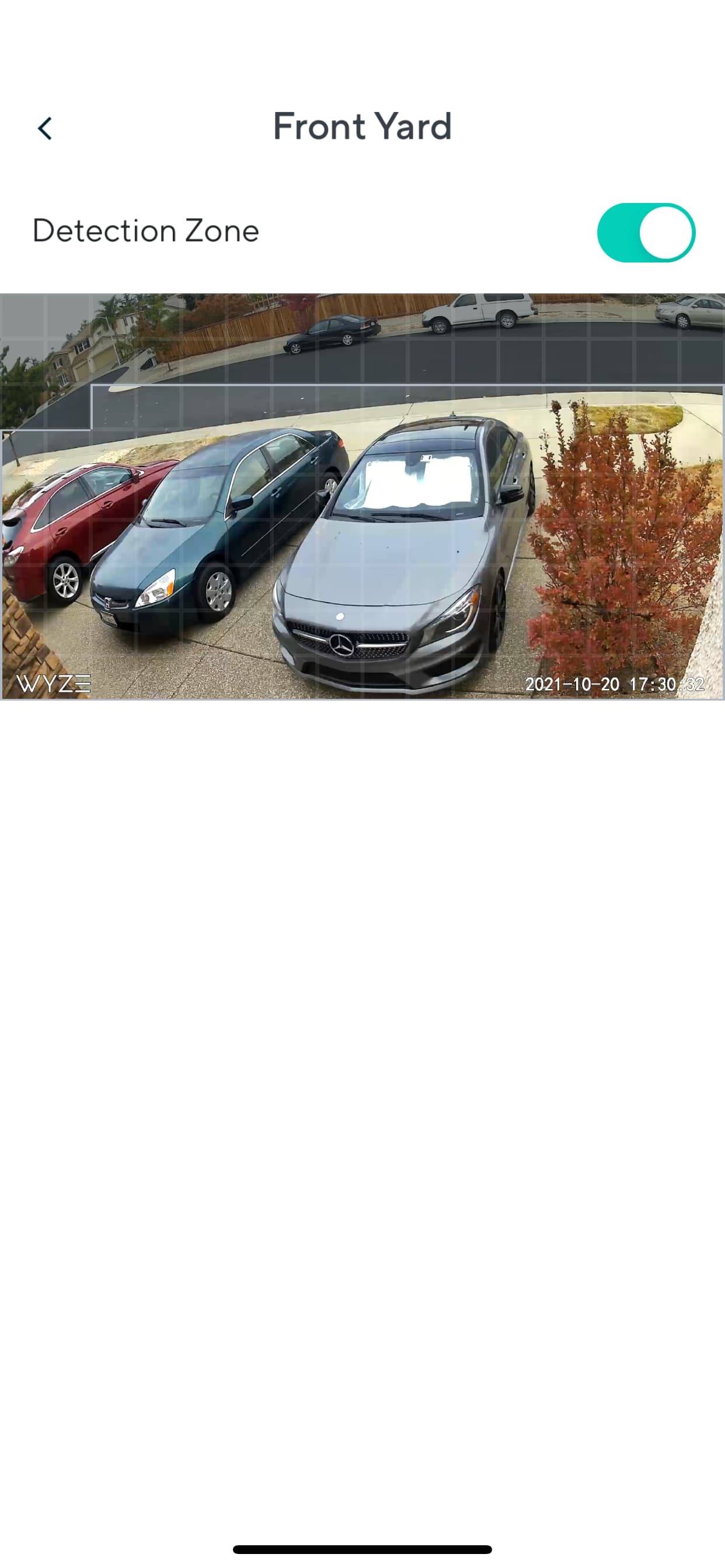

- In your zone settings, at the bottom right of the area you blocked, I would remove the blocking of the last 3 boxes to ensure you cover the full car in your driveway.
Then I would change your recording cooldown to 30 seconds and change your max video recording from 12 seconds to something around 2 minutes or more.
If you can, I would remove the Car selection in CamPlus AI. That will limit the notifications on the Cars passing. However, you may be caught up since I believe you indicated that the Notify on All motion is set.
I would increase the image sensitivity to 75 or so. That is the part the looks at what changes in the image. The distance will eliminate the street noise. you may want to increase that as well to extend out distance it looks at. Make sure your entire driveway is covered.
Finally, I would pivot the Camera up a little so the shaded area for PIR covers the middle car entirely.
When you said back left tire is where a rock was put, I am assuming it is based on the Camera View. If so, clearing the blocked area may help out as that section was blocked. Since they had to bend down to get under the car, they may have been hidden by the car and the area you blocked. Just an observation.

Pic showing the adjusted detection zone.
and this is with distance 92 and image sensitivity to 100.
So it appears that, besides the first car in the detection zone, camera sees nothing beyond that. or it just went to take a nap from time to time on it’s own.
Thanks for the additional information. I believe the individual walking between the cars is what the initial trigger as it is in the PIR Zone as shown in the BlueGreen shaded area of your attached image.
Is it possible to raise the Camera so the BlueGreen shaded area ends up at the back of the Car.

@VPhan1503 , one other item to try, although I don’t believe it is the issue, turn off Detection Zones. In the past there seemed to be an issue, unconfirmed, where Zoning seemed to interfere with detection.
@spamoni . Yes I can try that but I thought by setting the detection zone, it overrides the default blue areas. Stay tune for me to try this.

Sorry I meant why it only recorded 7 seconds if 12 was the max setting… I would still increase that to a minute or two if you foresee more issues in the future.
Keep in mind, the longer the recording and the lower the cool down, the more battery that will be consumed and the more often you will need to charge.

The latest, as suggested in earlier note on the thread, is 30sec cool down and 12s recording.

The biggest problem with your setup is location of cam. Most of the heat signatures within your PIR detection zone don’t move horizontally (left/right). You could mitigate this somewhat by relocating the cam to the left in front of the middle car, but even that isn’t ideal.
