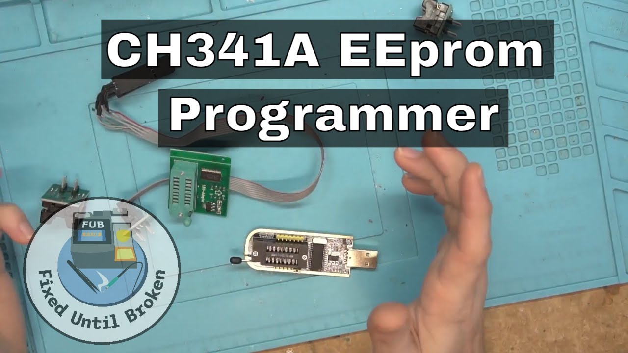

If I am correct, the ROM chips is where the firmware is saved to. If we find the ROM chip, then theoretically, we can replace it and re-write a working firmware and it should work!
I took mine apart and I believed I found the ROM chip (cfeon qh128a),…
Good thinking!!
Next step is to actually read /hack into the flash…
That is definitely something for well versed hackers I believe since there is most likely a unique ID / checksum in there which would prevent the use of a generic binary.

I do have one of those firmware flashers listed in the post above but I am not going to bother tearing apart my camera in the name of science since mine is under warranty (and within my stores return period).
