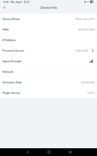

Another minor issue with 4178. I needed to check Device Info on my v3pro this morning and discovered that the Network field was blank.
Everything seems to be working. I cleared caches, restarted tablet, restarted router–didn’t help. It’s a minor issue.
P. S. Spot checked my PS v3’s, v4’s, BCP’s. Did not have this issue.
Hmmm, I am on Android, pixel 7 Pro, and my v3pros on the same firmware as you are showing the ip address…
That’s bizarre. I have 2 AP’s and this AM I decided to switch AP’s. I reset the v3pro and reconfigured it. All seemed normal until I looked at Device Info.
I wonder if this is a case of a glitch during configuration. Later on today I’m going to factory reset and see what happens.
Thanks for checking.
Edit: for the record. Samsung S24 Ultra, Samsung A9+, both android 15.

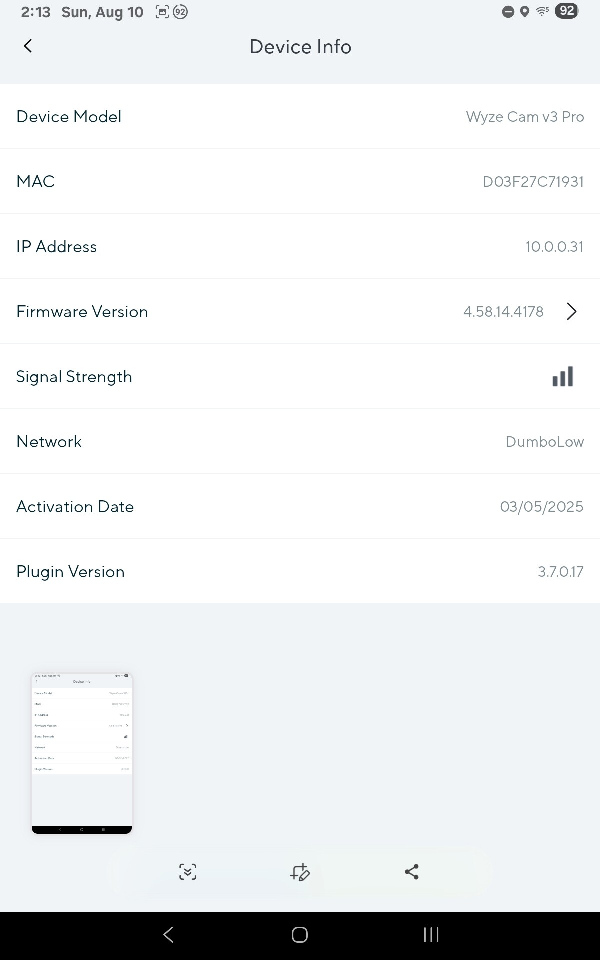

Had some free time this morning and decided to factory reset the v3pro. Before I proceeded I checked Device Info.
Self healing feature must have kicked in. The IP and Network are filled in.
Problem solved👍
