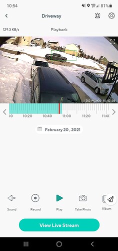

Note: Just looked, the last 2 days, the WCO camera’s have not picked up any motion. I have it set for notification on Person.
