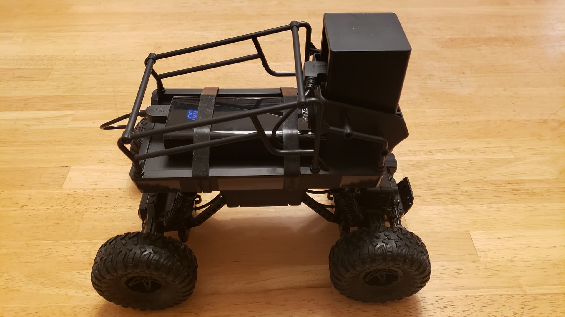

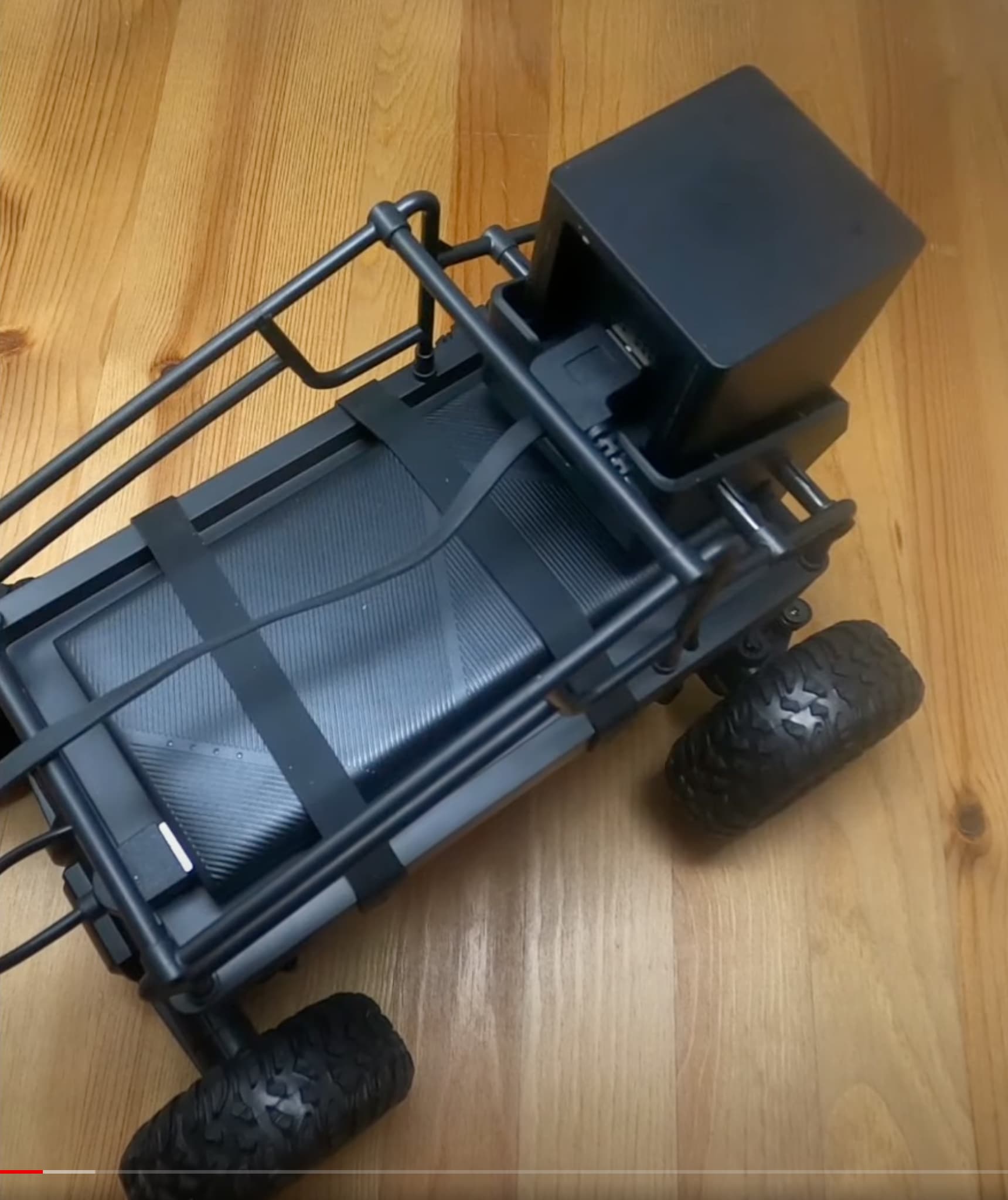

So this person did it wrong? (Note the flat cable going into the micro USB port).:
Where is the flat usb cable going? Remove that and that’s how I’ve use my car. One cable from front of car into camera, and one from back of car into battery brick.
Yes, you should not need to do that. The type A from the CAR should do both power and data to the camera.

Yes, that configuration is incorrect. When in doubt, follow the directions. It should like this:
