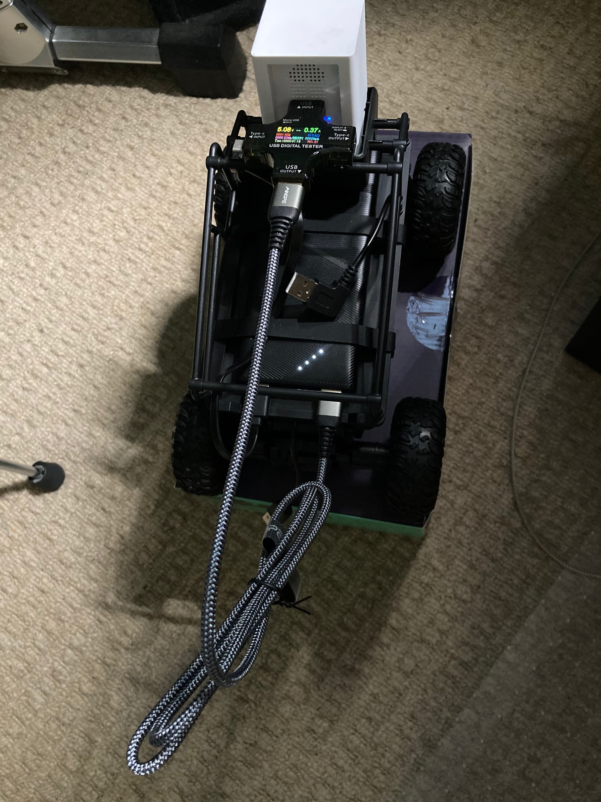

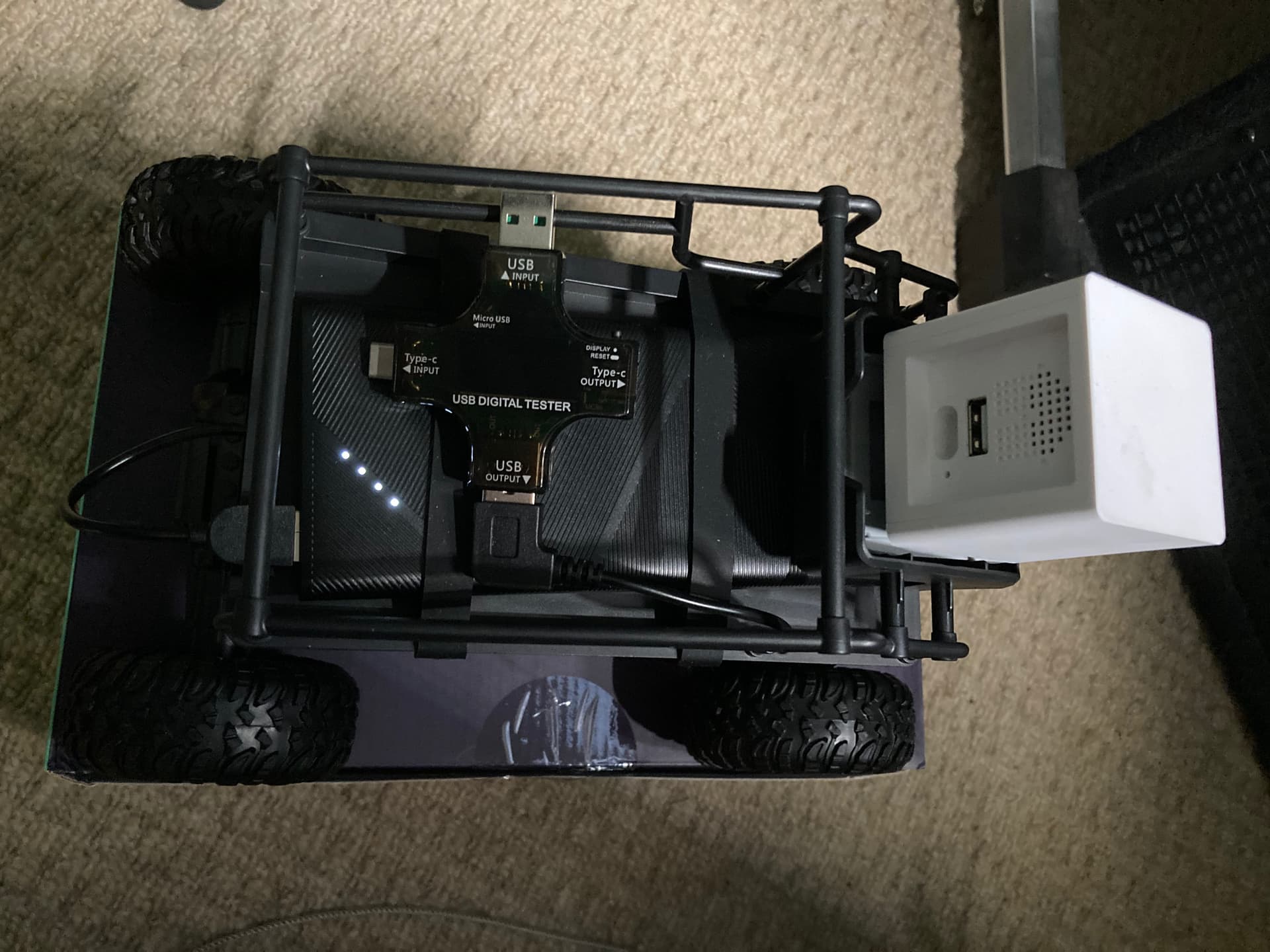

Omgistony, yes the battery is charged and supplying power … it can power the camera via the short micro-USB power cord that comes with the power bank (LonnieM’s photo).
It does not work when connected like in Seapup’s photo.

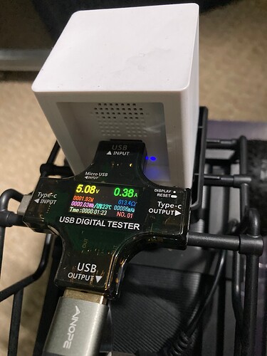

Just got the USB A-A cable and tester:
looks like the camera will take it’s power from the USB-A port :slight_smile:

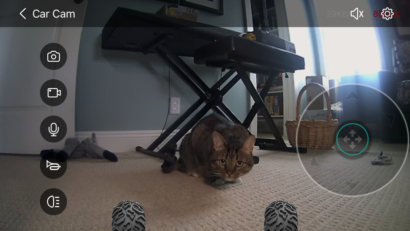

I viewed it’s video from the Wyze app – seems to work fine this way.
However with the Car plugged into that jack in the Power Bank, the camera connector is not supplying any power:

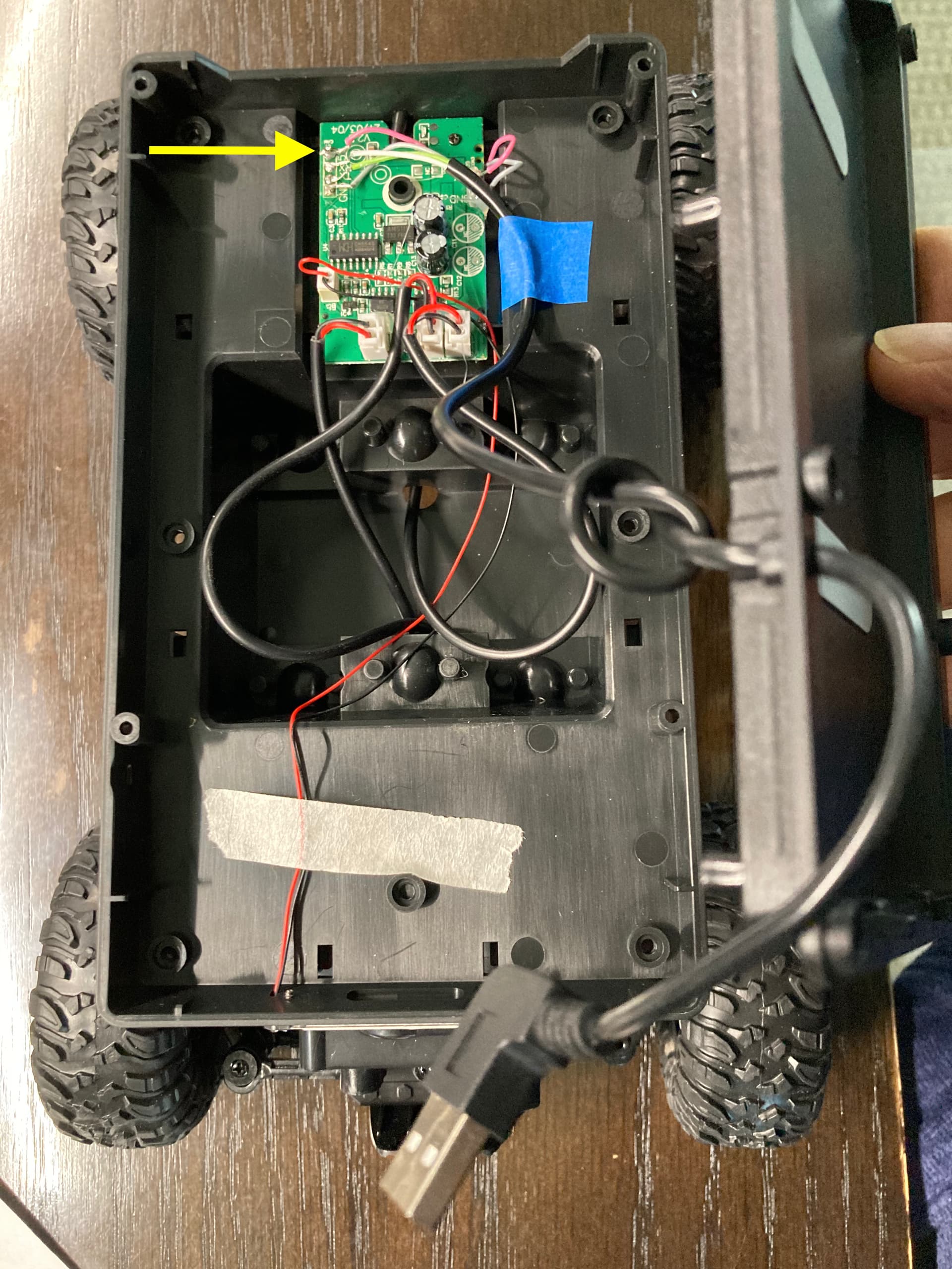

So I figured no risk to take the car apart now … turns out it was one of the things I had suspected (hoped for) … simply a solder connection not made properly … the pink +5v wire was not connected:
5 minutes later using my trusty Weller and I had a working car.
