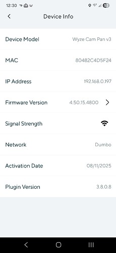

I finally gave up and flashed my 3 - v3’s back to firmware 4800 just this morning.
All 3 took it and live view is working again.
Just to be safe make sure that you remove the V3 from the beta program.
A 32 gB drive with FAT is highly recommended.
I’m now on:
With app:
