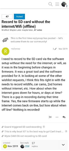

It has been requested in the Wishlist that this characteristic be changed.
If you would like to request that Wyze add this feature, follow the link to the official Wyze Wishlist, vote for it at the top, like :heart: some posts, and add your reply post to support the request.

I just tested the link in my Chrome for Android browser and it worked. You may find it by searching the Wishlist for the title.
