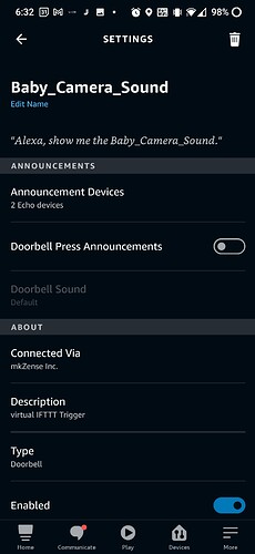

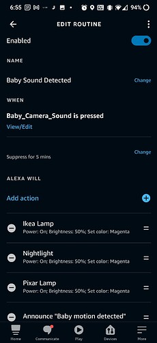

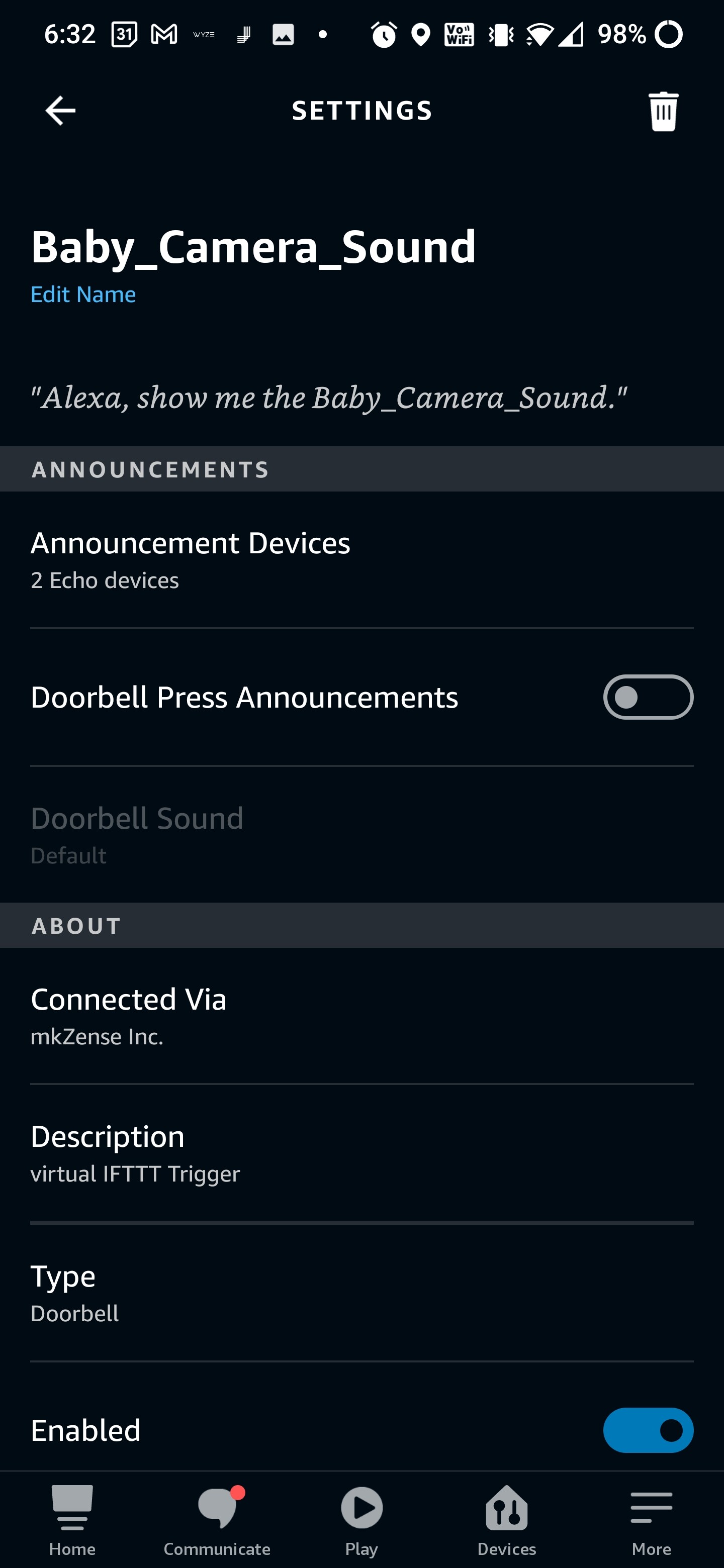

FOR EXAMPLE: I have a V2 camera setup as a baby monitor (perviously it was a V3 that I JUST moved outside), and use in combination with the Alexa skill “IFTTTTrigger” to trigger two separate routines to audibly announce on both of our household Alexa’s, and visually (by turning on and changing the Wyze color bulbs to pink) if the baby is moving or crying. Where it gets weird and makes me think this is on Wyze’s side of things is that when I look at either of the triggers (motion or sound) I’ve created using this Skill it shows them as a “Doorbell” type of device in the Alexa devices tab (pictures included below for reference), yet they both still work as triggers, kinda… Weirder still, around the same time that the Wyze doorbell presses stopped working as routine triggers, the colored Wyze bulbs I have set up around the house to go pink on that same Alexa routine stopped turning on and going pink, yet the audible parts of the routine announcing either movement or motion (screenshots of the routines included below for reference) still play, and the LED light in the Flex in the kitchen still goes pink (FYI, it’s technically an Amazon light)… Further muddying up the waters is the fact that my old Wyze contact sensors still work with Alexa as routine triggers (I have them set up to announce doors opening and closing on my Alexas). ![]()
This shows that other “doorbell” type devices still work on Alexa as do third party devices/services other than Wyze’s doorbell and bulbs with Alexa, however there’s a breakdown somewhere in the communication chain between Wyze’s doorbell and colored bulbs +Alexa routines, thoughts?..
