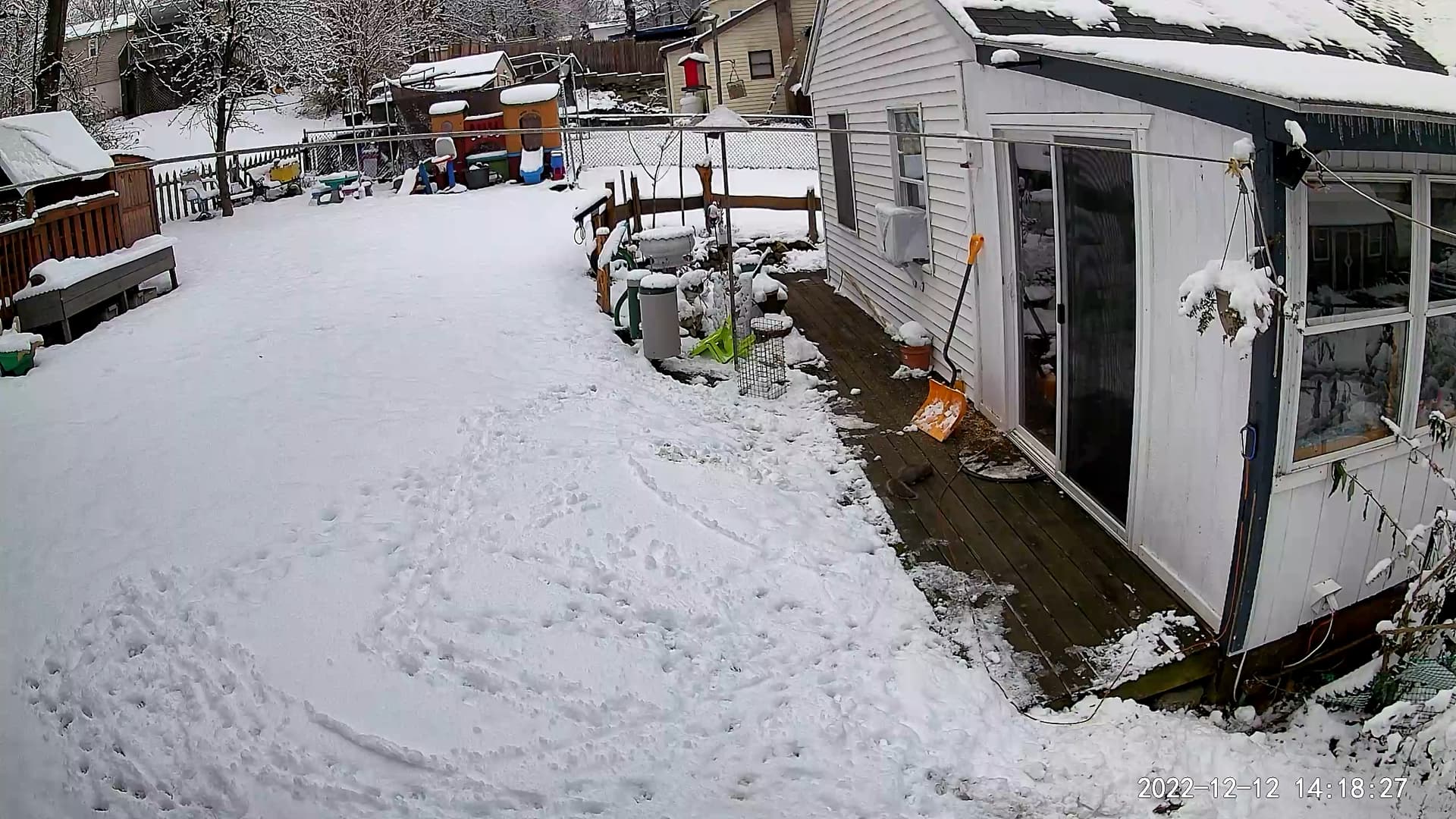

That would make sense. The only change between the whole past and today is snow. It’s funny how there seems to be a fine line between working and not. Hopefully that fine line will make the fix easier. Here’s the view by the way, looks nice and clear, I like it!
