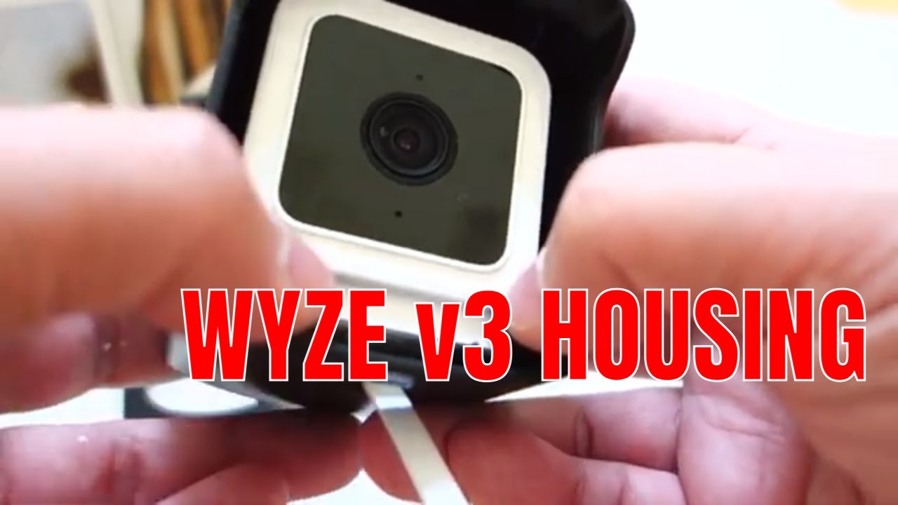

Can’t say the case shown in the video is exactly made for the V3, but I have used cases like these for the V2 and OG cameras, mostly because they lacked a 1/4-20 screw for mounting options.
Regardless the issues depicted in this thread would not be mitigated with these, or any cases I have seen. Largely because the moisture gets into the lens from the front. None of these cases provide any protection from the elements on the front.
