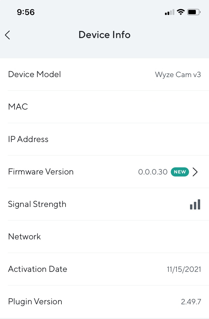

This has been reported and discussed elsewhere, but figured the issue is more than worthy of its own thread. For those of you that still have V3 cameras offline, you may want to check the firmware version listed within Settings | Device Info.
It appears that several of us have V3 cameras that will not come online after the outage. Prior to the outage, all of my V3 cameras had the same version of firmware. After the outage, one of my V3 cameras now lists firmware that is used for the original Wyze Cam Floodlight.
One user has reported that removing the camera from the app and then re-adding it resolved the issue. I have not attempted any fixes yet as my camera is in a difficult to reach location and outside in 10°F weather. @WyzeJasonJ stated he will let the appropriate people know about the issue. That was over 10-hours ago.
I am hopeful that a manual flash of the firmware will resolve this issue without having to delete and add the camera. I will be trying this later and will report back my findings. Here is a screen shot of my V3 reporting Wyze Cam Floodlight firmware.

Having the same situation with a V3 cam. One works fine and another is inaccessible and shows fw 0.0.0.30.
Hmm, I cannot find that firmware version listed for any of the Wyze products. I think it might be the original version of the Wyze Sense Bridge firmware?

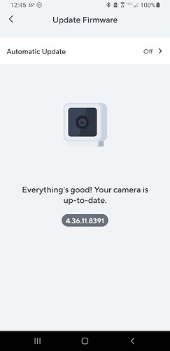

Also, do any of you have the Automatic Update toggled “On”? Just wondering how this mess came to be…

I turned my auto updates off a long time ago, you are the one who told me how to do it. :rofl:
