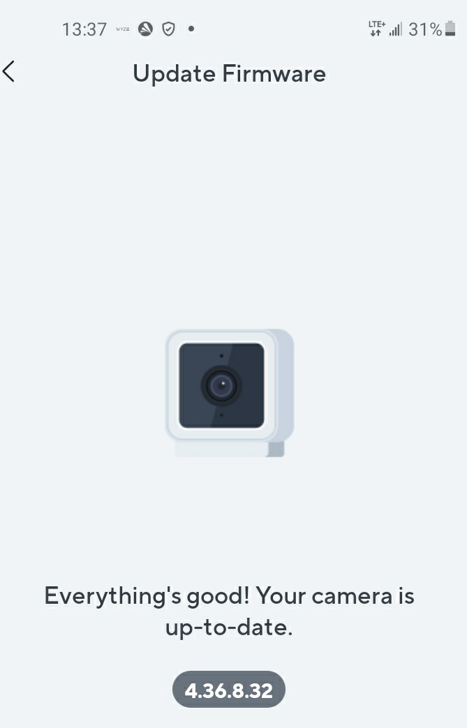

Yesterday, I tried upload pix to my posts, confirming that my firmware is up to date. It did not upload. I will try again today.
I am waiting for the NHL playoffs, too.

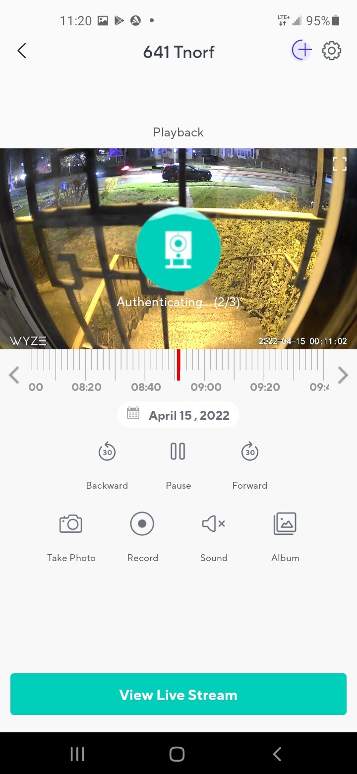

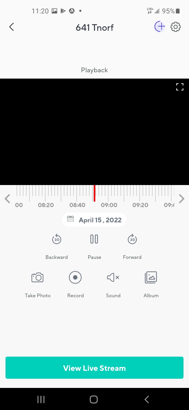

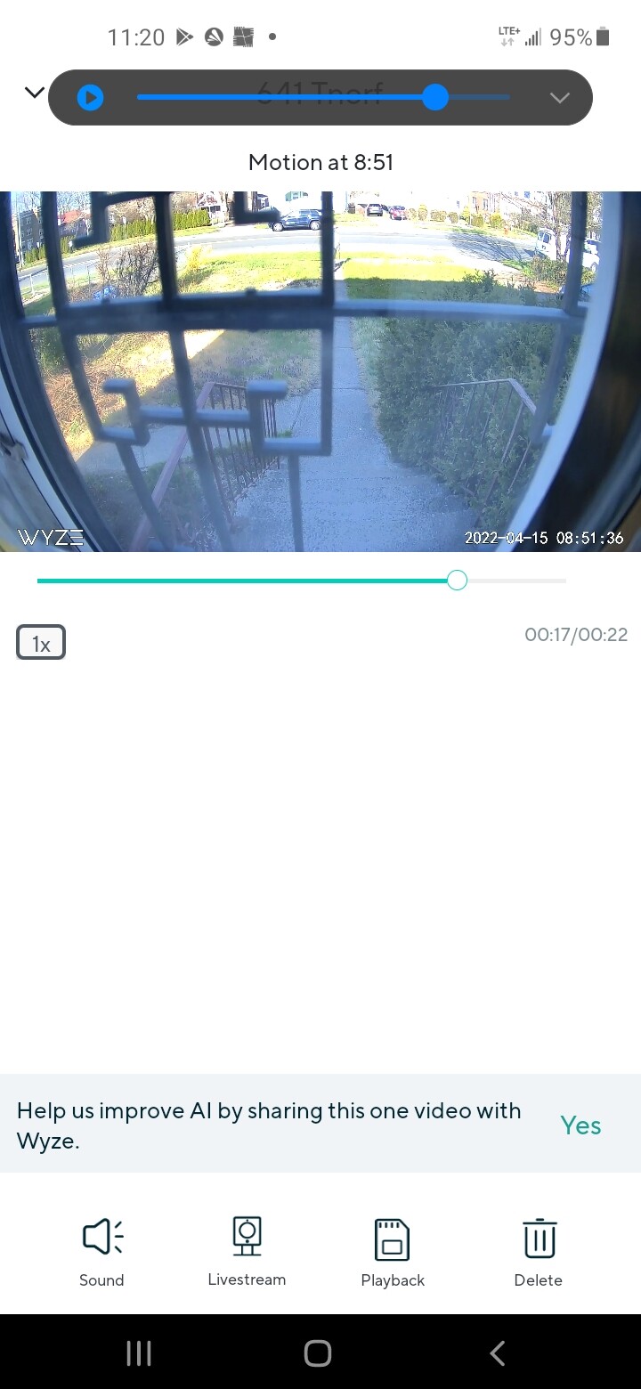

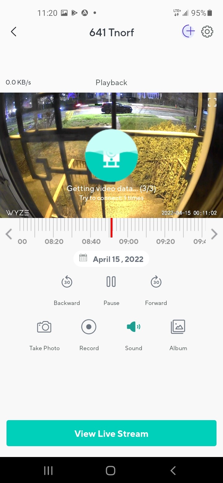

Here’s The pix?
(Firmware incl.)
Screenshot_20220415-112114_Wyze
Caught as many screen msgs as I could.

Yep. See that it is not authenticating to the cam when launching from the cloud Event video. Does it give you the same failure to connect error when launching from the live view or is that a different error?

I reset the cam, I think it worked for a moment. Not too sure, about that. As the old, "Force close app & pwr cam ", msg’s have returned.
Now it says " Camera not Connected ", then it reads the SD, It said the same, then Reads the detection settings, too.
I’m no expert, but this is a laggy n camera sorta bug.
It even threw in an “insert sd card”, before displaying it’s volume and settings.
