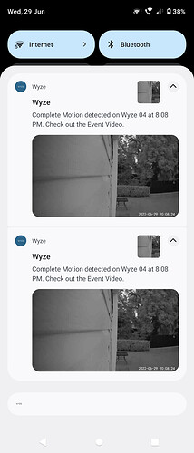

I have had two notifications for each event for months now.
Since they removed the slider that allowed events to be rewound before fully uploaded I now know what it is.
I get the first notification as soon as something triggers it - the second notification comes after the video has fully uploaded.
I am sure that Wyze didn’t plan this “feature” - so I assume it is another bug, but at least it is consistent and reliable ( unlike some other features!)

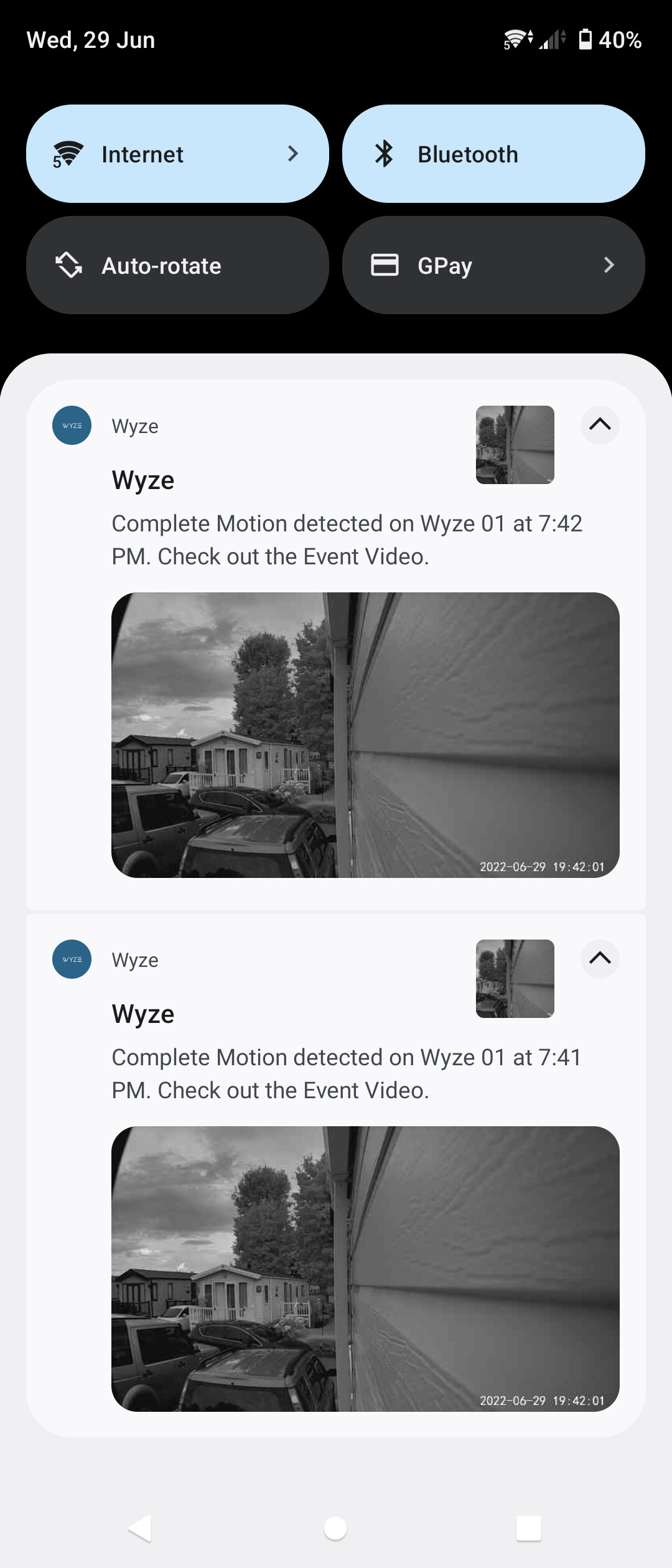

This is just opening a door - it happens every time on all eight cameras.
It is actually a plus point as the second one arrives after the whole event has finished uploading so I know when I can rewind to see what triggered the event. It would be much better to have the old system back that allowed rewinding to the start before the video has completely uploaded

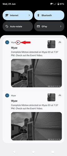

Find out what this “alert” icon means and you’ll have your answer:

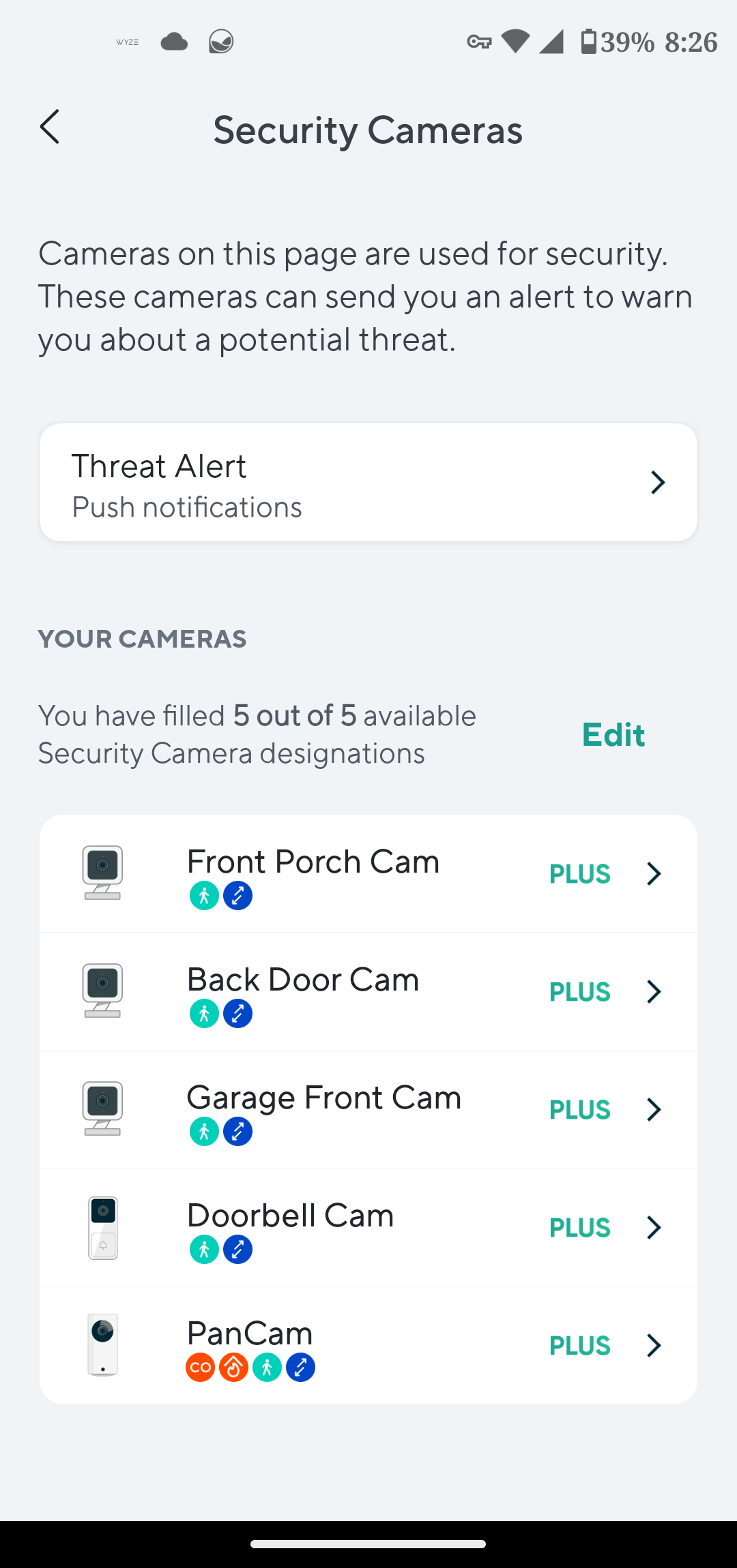

I receive 2 notifications only for the 5 cams assigned to HMS alerts. One notification is the normal “Person detected”, the 2nd notification from the same cam is “Complete Motion”. I think the 2nd notification is mislabeled and belongs to HMS. I don’t receive 2 notifications from the 30+ other non-HMS cams.
I just ran a test and removed one cam from HMS. Turned alarm to Away mode, walked in front of cam and received only a Person notification. Reassigned the same cam back to HMS, turned alarm to Away, walked in front and now get the usual 2 notifications.
I don’t know. I have no OS/UI that appears like yours.

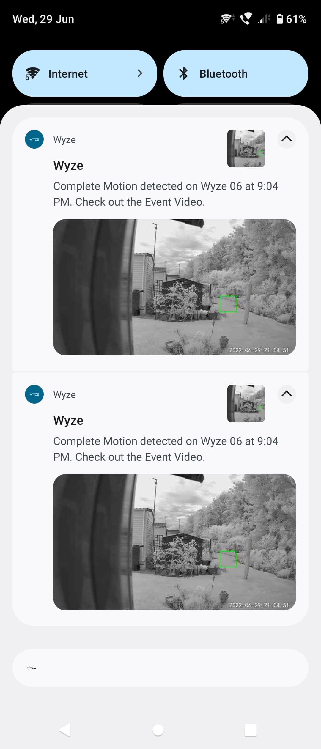

Another one - different camera BUT - no icon on either of them!!!

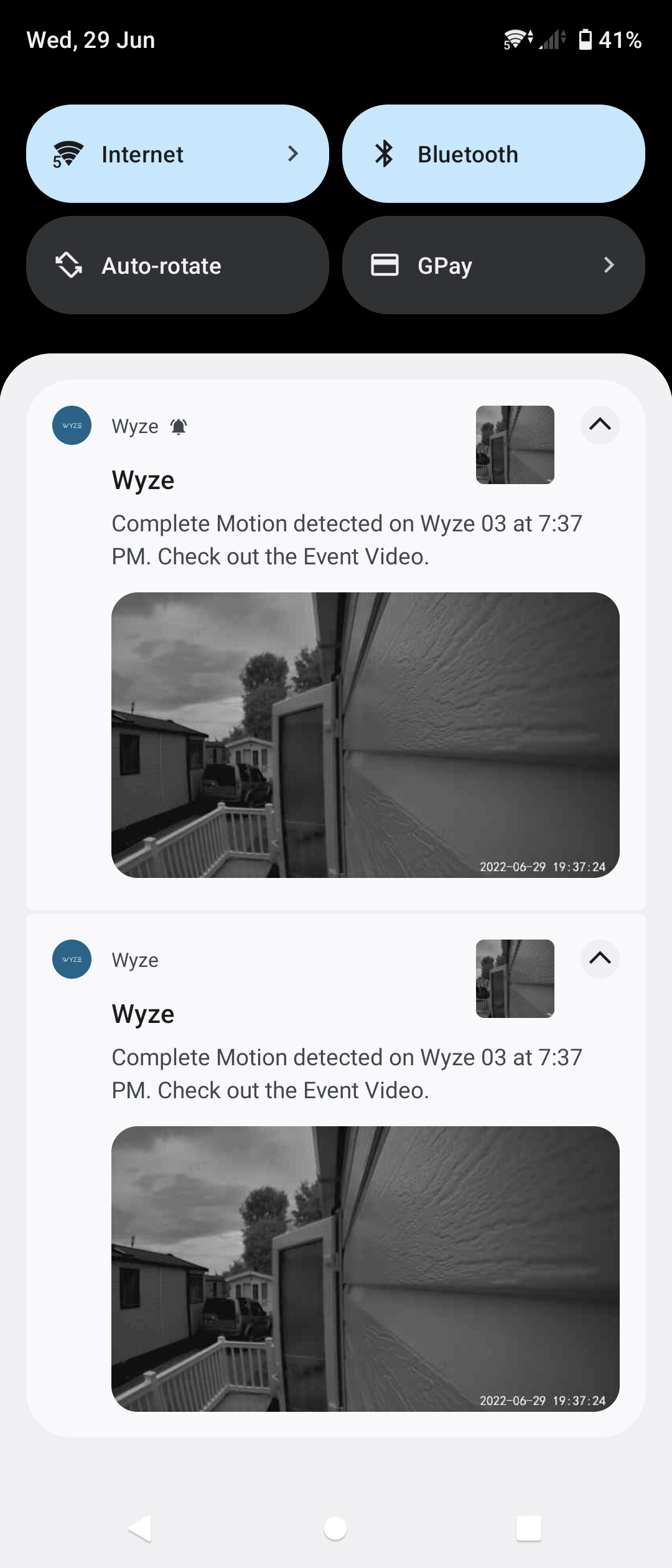

Next one is a different camera - the icon is on this one.
All cameras have identical settings

I have Threat Alerts set on 5 cams to Person and Motion.
The first 3 cams are V3. The Doorbell Cam is absolutely useless as it is next to impossible to activate unless the wind blows. The PanCam is inside where my motion sensors will set off the alarm (yeah… I just realized the irony… Will replace that in the list with another V3 outside). I also have CP PD set to notify on each of these cams.
At any rate, I just armed the HMS and walked out to the mailbox. I triggered 6 PD events on the 3 V3, one each outbound, one each inbound (one it tagged me as a package).
However, I only received a grand total of 6 notifications for the 6 events in the Events tab.
