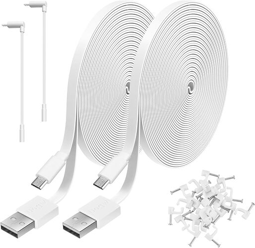

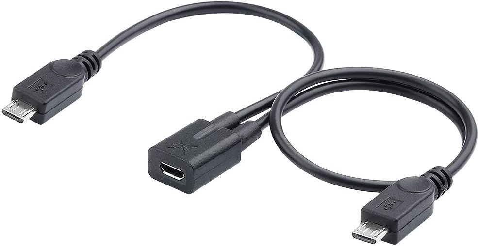

i googled “Micro USB Female to 2x Micro USB Male” splitter and literally the first one had a guy reviewing him using it for two wyze cameras lol.
so i bought it,
and i also bought and i also bougt this
i’ll try splitting and see how that works, if not i’ll just have to be out there running that wire in this 100F heat…again :tired_face:

With the splitter, it doesn’t look like it will fit in the “boot” that the cams include, maybe if you stretch it. Even with the boot, not a bad idea to use some sealing tape on all the connections since you’re going to have several junctions.

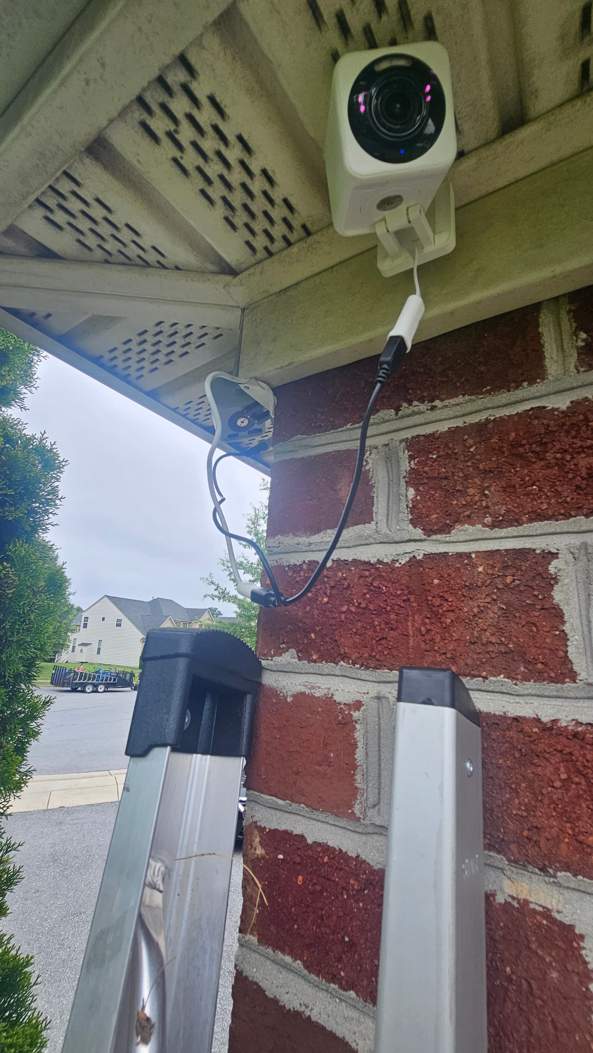

Took down the Pan camera, replaced with two cam v4, used the splitter, works for for now.

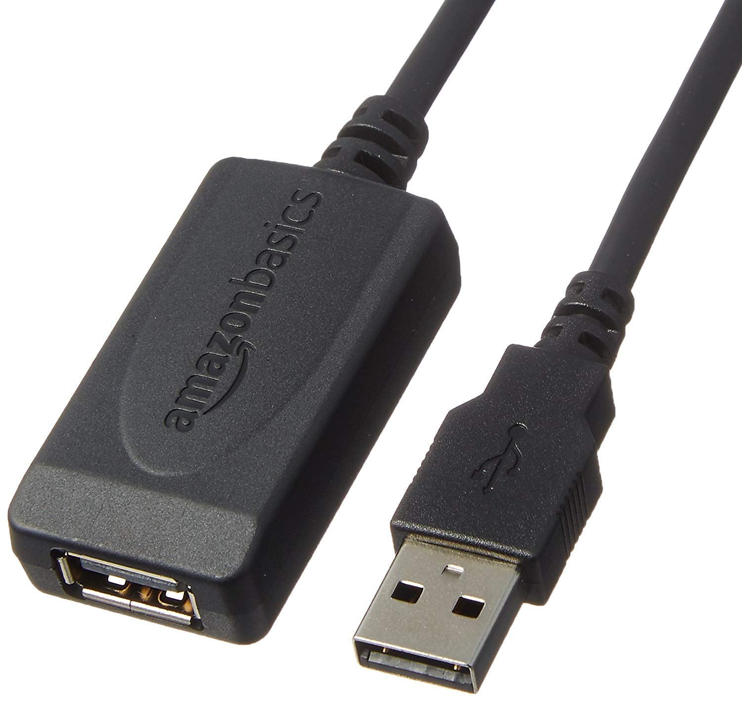

Unless you use a USB active extension cable
I have several cameras that are connected to these.
Jeff says I bought them in July 2023. They are still going strong.
I think you just got lucky. That is a data repeater to regenerate the data signal, it does not do anything about voltage drop for power, even says not to use it with cameras or other “high power” (which with USB 2.0 is actually pretty low power) devices.
  • NOTE: Does not work for charging smartphones or tablets; not recommended for webcams, video cameras, devices with high power consumption, or home-theater electronics.
Really the only way to account for voltage drop is to increase the diameter of the wires (and also ensure your power supply has a bit of extra current available), or use something like PoE that can increase the input voltage to account for the drop. You could homebrew something with an adjustable voltage supply but that’s going to be risky and not very practical.
I have three of these that have been in use for 2 years outside shielded from the rain and snow.
Technically it shouldn’t work like technically a bumblebee shouldn’t be able to fly.
I remember when HEI ignition was introduced. It supplied about 60kv through the spark plug wires to compensate for the increased spark plug gap that was increased because of a lean fuel mixture.
I went to an actual GM training class to learn about this thing that replaced points and condenser. We were told to NEVER pull a spark plug wire on a running HEI engine because the voltage would blow a hole in your elbow trying to find ground. I’ve been bit but it is brief because your muscles don’t contract and you can let go. One thing I learned from experience is never lean over the fender when pulling a plug wire. Sure wakes up Willy.
I’m not saying it shouldn’t work, just that the “active repeater” portion isn’t actually doing anything in your scenario, a standard USB cable of the same length and gauge would work the same way. My guess is the wires in that are a heavier gauge than many cheaper or flat USB cables so that part is probably helping some.
