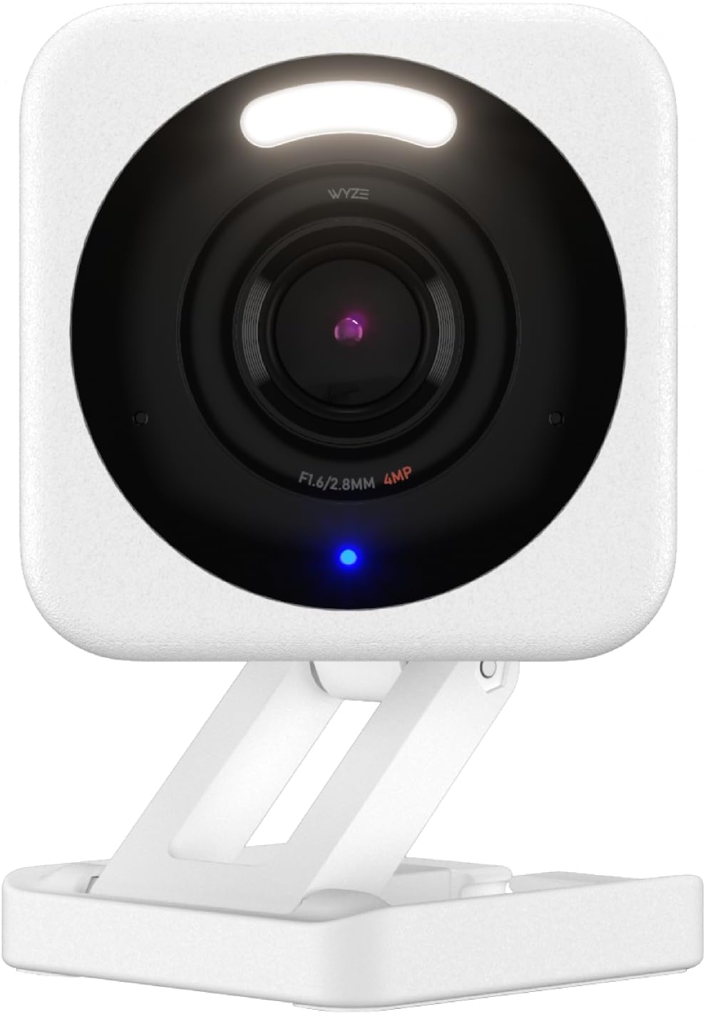

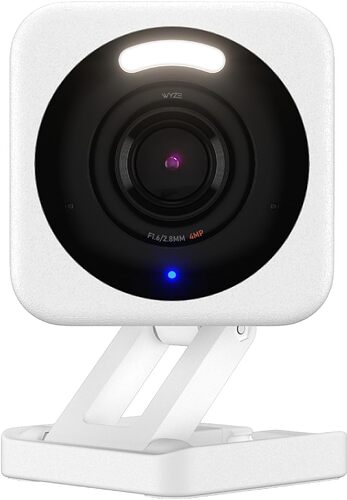

I recently mounted the latest pan camera on the corner of my garage to monitor two sides of the house however i didnt take into account a big ole tree blocking a portion of the view when it turns.
Im now thinking of just getting a v4 camera to just mount to stay stationary up there.
I dont want to run any more wires, and seeing one cam is already up there i was thinking
Is there a usb micro (i think it is) spmitter and use both cameras via one power supply and it will be sufficient?
These are the two cameras
Thanks in advance

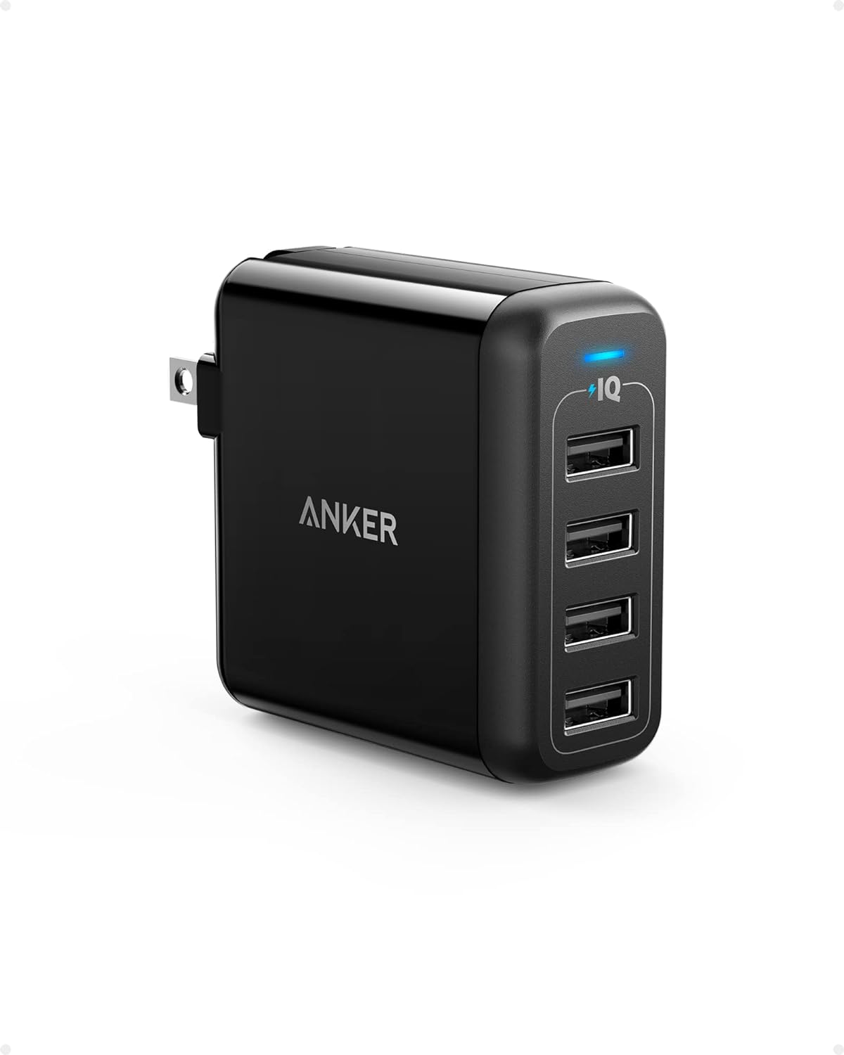

I have several Anker 40 watt 4 port wall warts for my outside cameras.
Jeffy says I bought 3 back in December 2020
They aren’t exposed to the rain because they are under the deck. They do see hot ~100F and cold ~10F and have been working fine for over 3 years. In fact, several of the power cables are 40 feet long and even with the voltage drop, the Anker supplies enough to make the v3s and v4s happy. I have all the WYZE wall warts in a drawer.
