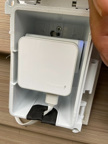

Same here. All my cameras except the one above my garage door have non-Wyze adapters. These are the ones I use, they are not as deep and allow me to use them with weatherproof outlet enclosures as seen in the picture bellow.
https://www.amazon.ca/gp/product/B07MCWDKWV/ref=ppx_yo_dt_b_asin_title_o01_s00?ie=UTF8&psc=1
Careful… that’s Canuk! Here’s the US…
