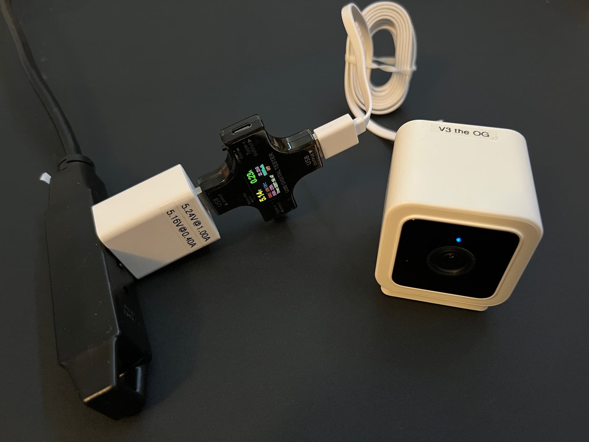

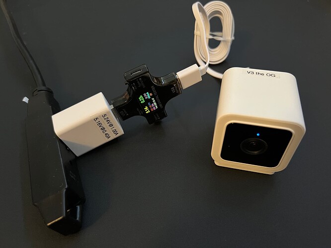

So how do you test the adapters? If you have an USB inline tester (these are great for troubleshooting!) then plug the camera into the tester, and the tester into the power adapter:

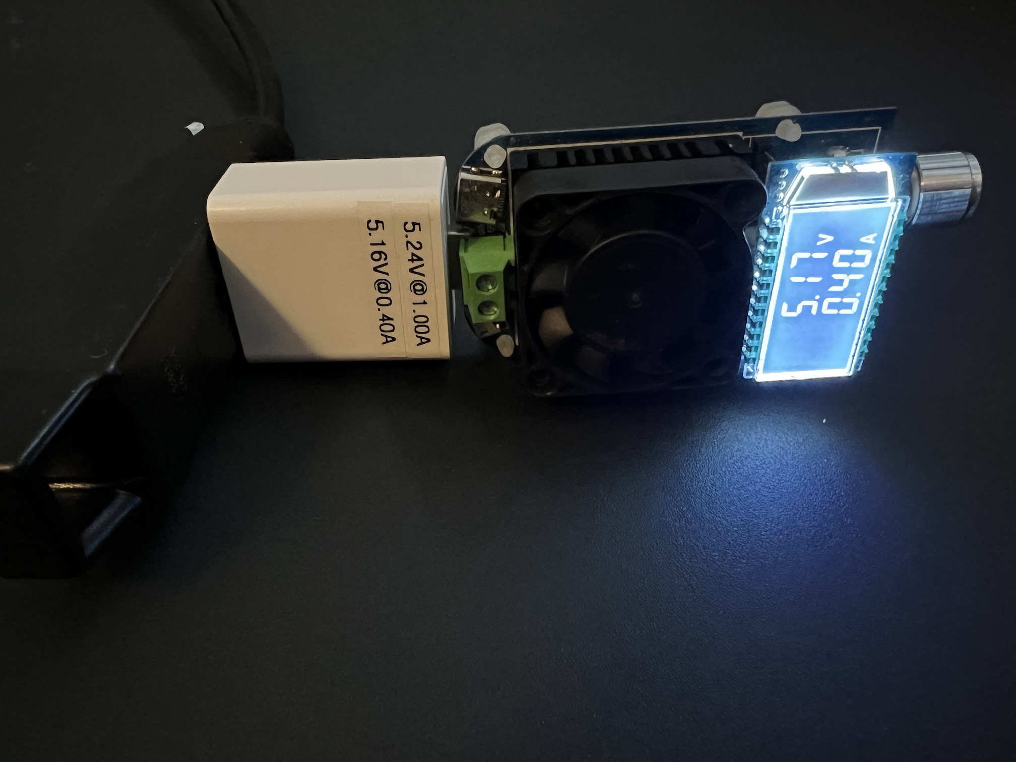

If you have a USB load as linked in the top message, then plug that into the power adapter and set it to the expected current draw:
You may notice the inline tester is showing only 0.23A, and I have the load set to 0.40A. Either will work. The 0.23A is how much the camera is drawing ATM, and the 0.40A is the maximum expected when the siren, IR lights, and recording to the SD card and cloud are all happening at once.
This is the same for my Pan Cam expected current of 1.00A. A Pan Cam draws similar to what a V3 does, except when it’s motors are running. So 1.00A is the expected maximum current.
Honestly, it doesn’t matter how much current you draw, so long as all power adapters are tested under the same load so they can be compared.
All you are looking for is which power adapter you own puts out the highest voltage to help with your long cable run. :slight_smile:
